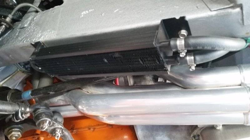

Aux cooler in front of radiator on my old Coronet. My new 65 Belvedere has the cooler mounted on the frame rail. I don't like that placement because of possible rock damage. I will have to change it.
