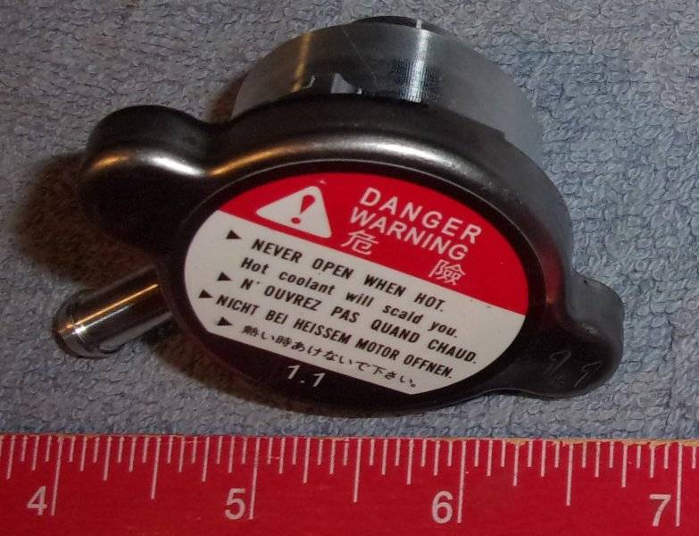

So I have a new Alum crossflow rad I am installing, I am making some mods to it like moving/changing the in and outs to AN fittings, and removing the trans cooler.
I'm not happy with the existing fill location/design, so I want to mount one on the top of the end tank. I purchased a small style pictured below for no special reason vs a regular size.
Is there any real downside to small radiator inlet caps that I overlooked?

It's marked "1.1", so I assume atmospheres or 16psi?. I hope they make higher ratings for that size, but its a good starting point I suppose..
I'm converting the car to E85 and not sure what heat range it will finally be in.
The 1.1 marking on the radiator cap refers to the pressure rating in bars. A bar is a metric unit of pressure equal to 100,000 pascals (100 KPa), or 0.987 atmospheres. One atmosphere equals 14.69595 pounds per square inch (psi)
So, for the cap pictured, 1.1 bar = 15.95415115 psi, or ~16 psi.

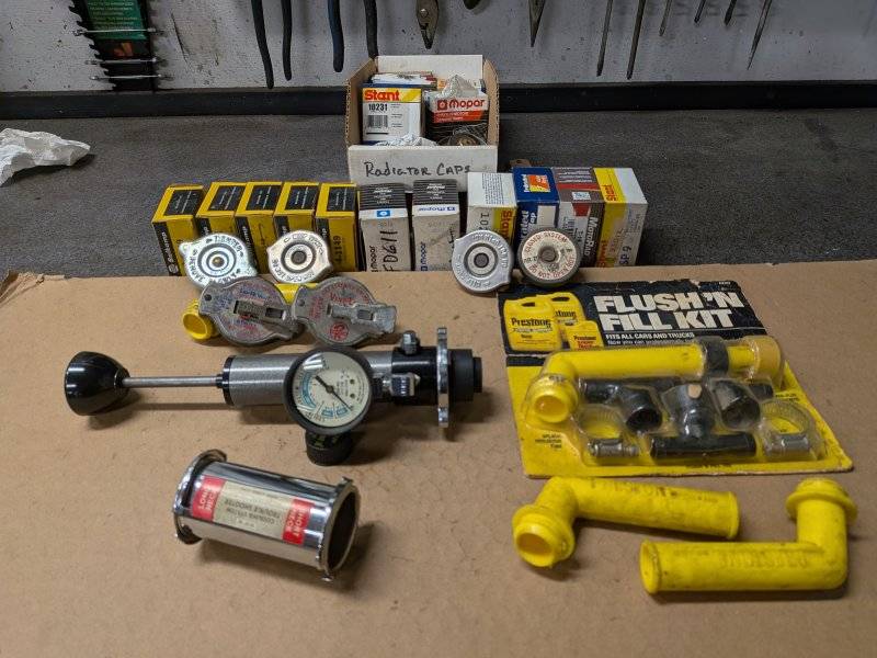

Likely no real downside to a small cap and inlet other than not being able to use more common "standard" size caps, or you might not be able to use these maintenance items, if you have them:
