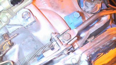

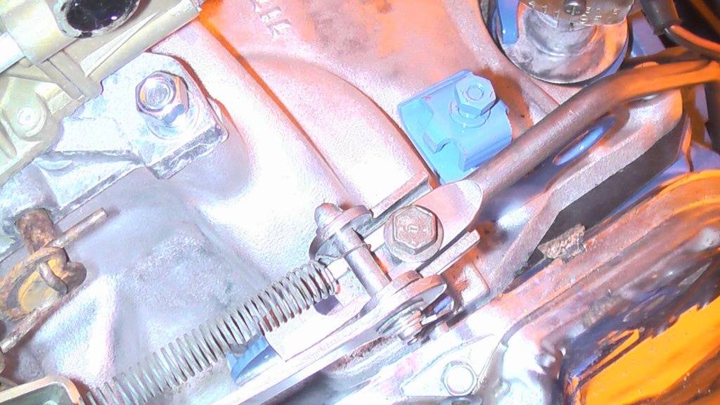

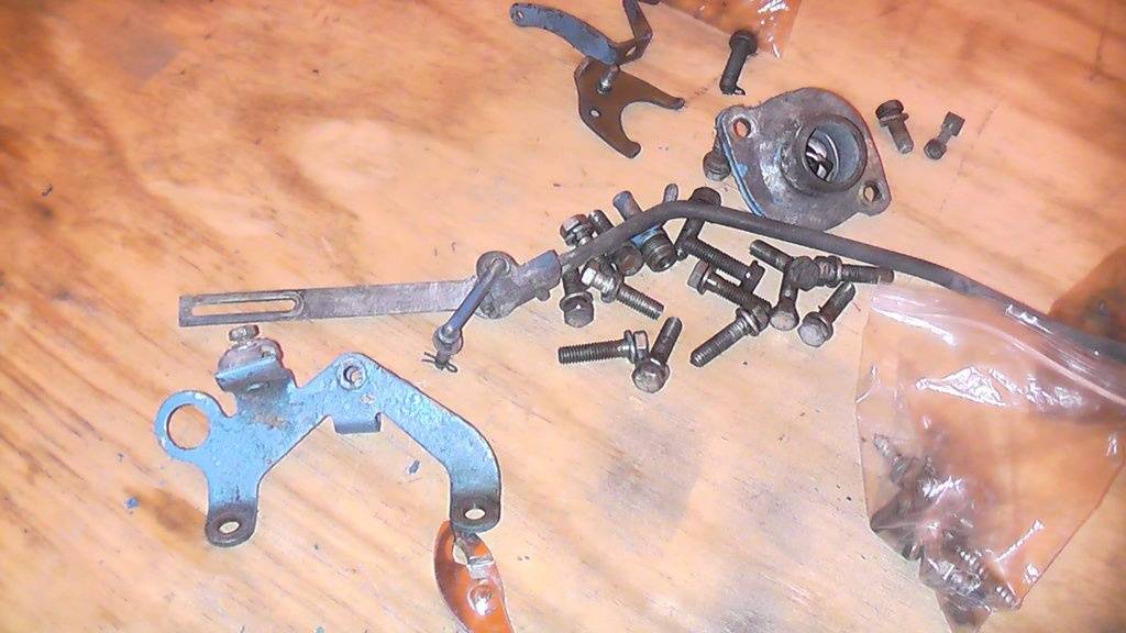

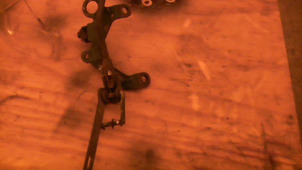

This kick down came off my 318 2bb,will it work with the 4bb holley I plan on using,. Never had that befor so un sure.71 Satellite.
Which Holley? Somebody here knows. I suppose all that matters is how the "slot" fits vs. the throttle lever on the carb. IF they're the same "throw" (movement distance forward & backward) AND in the same location (the slot arm) relative to the carburetor's throttle, then YES.
Otherwise, I think you'd have to
a. modify the bracket to move the whole kickdown forward/backward as needed
b. change the slot to make it longer....say by cutting the slot in half & welding in a couple rods or something (top/bottom of slot) to make the slot longer (in the front)
c. grind more metal out at the back of the "slot arm" to make the slot longer (in the back).
Not knowing any better, I would want to see:
a. how the throttle lever of the 318 2bbl. carb fit into the slot arm.
b. how far forward & backward the 318 2bb. throttle moved inside that slot.
c. duplicate that same "relative action" with the 4 bbl. Holley
I'm SURE someone on this site has done exactly what you're doing & knows better than I do.
Hey Kerndog, it sounds like you've tried this before.... what exactly didn't line up or work right?
Just looking at the picture, the bottom/left (blue) piece that bolts onto the intake will probably bolt up to the 4 bbl. intake (or only take a slight modification to bolt up). The transmission is in the same spot, so the long arm going down to the transmission should be usable. That leaves me "thinking" that you'd just have to modify the "slot arm" and/or that little rod that attaches near it with the cotter pin in the end. OR...am I completely dreaming?
Somebody(like kerndog) needs to expand his answer, but from what little I know those 1-piece rode are a pita for proper setup. Give me the older(2-piece) any day.

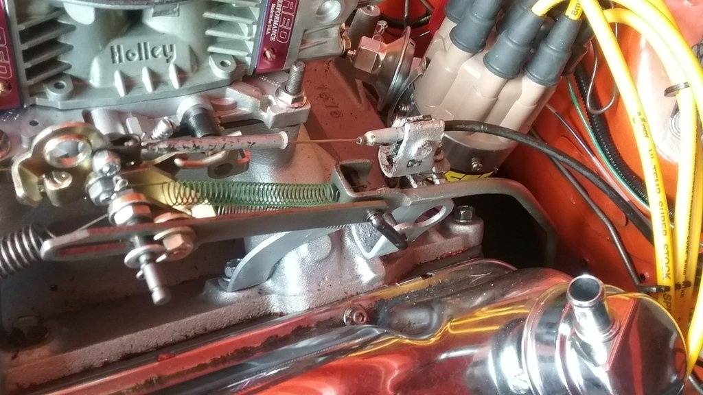

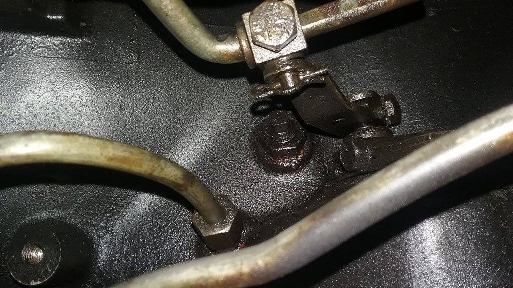

I just made a swap to a Holley 750 DP on a 340 72 RR with a one piece that looks a lot like that, but the rod that goes to tranny lever looks shorter on yours than on mine. It took me some tinkering, bending and fabricating, but I got it right. Unless you use a cable, you will almost certainly need the Holley throttle lever part no. 20-7. I had to use a nut and bolt on the slot at the carb to increase rear travel to get throttle to move tranny lever all the way back at WOT. My slotted arm was not threaded or adjustable and that made it tricky. It's not ideal, obviously, but it works. Also, If you look at the adjuster "box" down at the tranny -- I'm not sure if yours has this -- I had to grind off the round stopper (still seen in photo) and thin the rod so I could get about 1/4 inch more movement of the box toward front of car. That allowed me to attach right at the point where you start to feel some pressure on tranny lever.
JG1966 Thanks for the help,I do have the holley leaver on my 600,my set up looks a little like yours,but it has the clip at the end,no box for adjustment,there is an adjustment at the top with a slot.

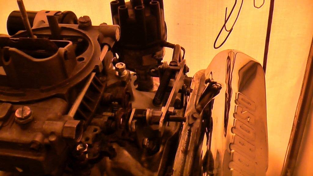

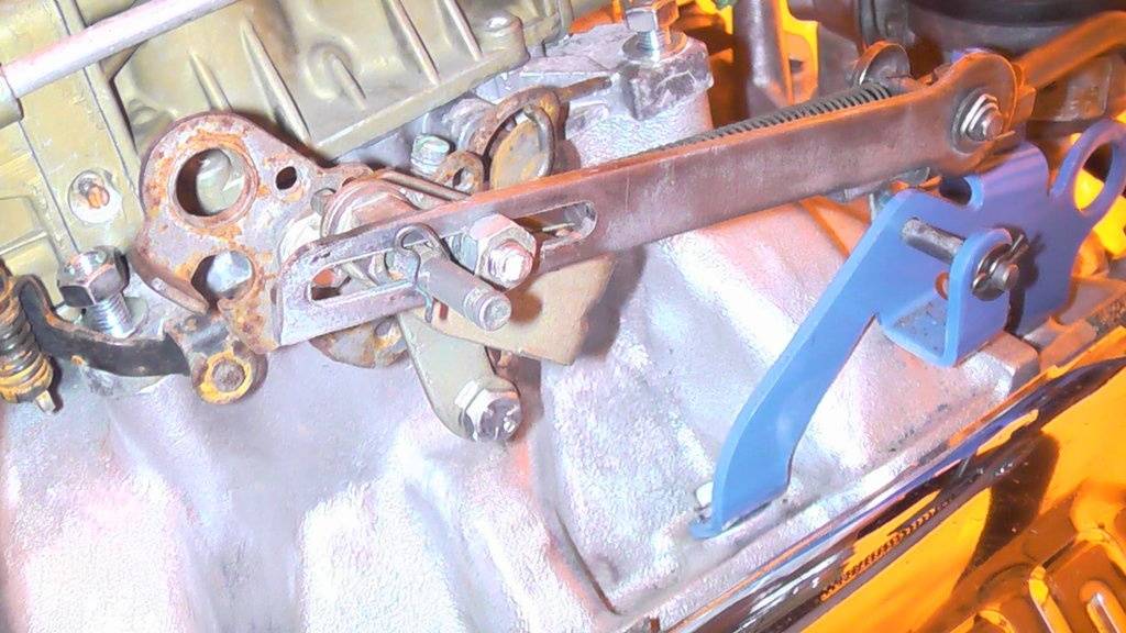

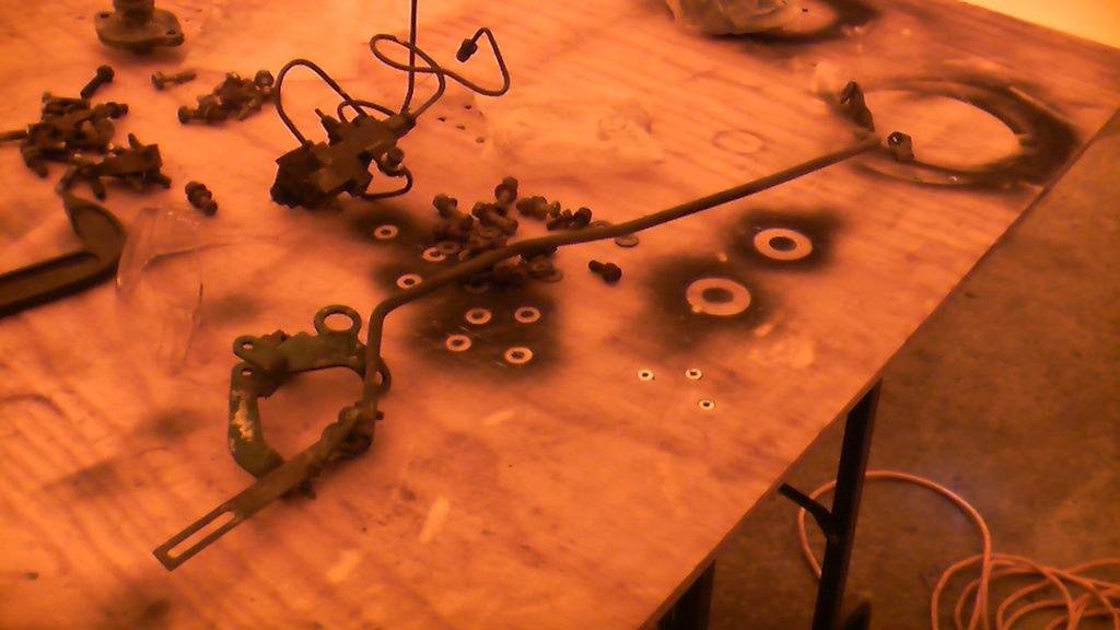

Well,its been some time since I work on the kick down adjustment,so with the engine on the stand i did some frig-en with it.As you can see I was able to use what I have.There is some adjustment with the slider don't know if thats whats its called,and some at the rod.The carb still has to be rebuilt,and linkages detailed.Thanks for all the help. Cheers.
Is that a nut behind the throttle shaft on the 'slider'? The kickdown linkage has to move at the same time the throttle moves and needs to be able to not interfere with full throttle either. Aftermarket setups are not covered in repair manuals but there's enough info in them to get you going on the right track....
The slider moves freely,it does move the same time.When your on a tight budget you use what you can.Thanks for looking.
Ddp, as long as you can get the proper travel at the trans it outhta work.
