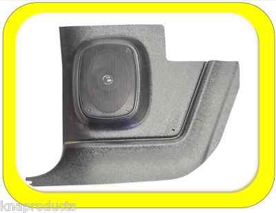

anybody try them . how was the fittment. quality?
Custom Autosound 64-76 Dodge-Plymouth-Mopar, Kick Panel speakers, 1 Pair on ebay seller knaproducts

I've seen them for A bodies,seems like where the speaker is located the wouldnt fit a 68-70 B body.Pass side has the vent box right there and dr side gas the E brake.It would have to be a pretty flat speaker i would think.I was sorta looking for something like that myself.
i am looking for my 64 polara. ebrake my concern. have emailed seller twice no reply. guese that should be enough of a warning...
I would love to find someone that sells kick panels with speakers for a 70 B body.........would save me having to cut holes in the door & door panels..........

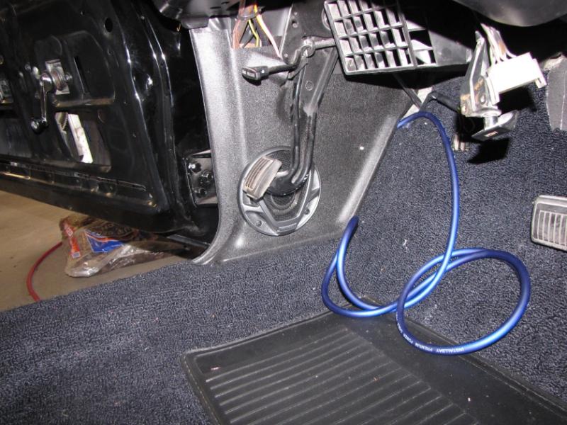

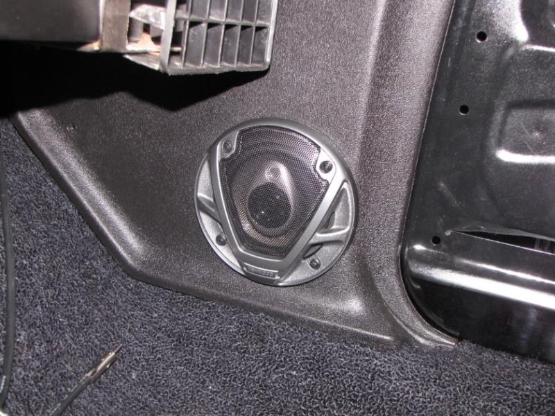

I installed a set of Kenwood eXelon 4" speakers in the kick panels of my '69RR. Bought an aftermarket set of the panels to install on and kept the nice OEM set of kick panels in case the looks of speakers there started to bother me and wasn't worth it for the sound quality/addition. The magnets on the speakers will settle into the open area of the hinge pillar is for the lower hinge bolts. Speakers come with a cardboard template to properly cut out the area needed as well as the mounting screws for the speaker to the mounting ring. Haven't seen a set of the B-Body aftermarket speaker incorporated set for our years, but the other ones I seen for A/E Bodies had some pretty crudy speakers in them.
Looks great......which speaker brand & model and size did you use?.......that was going to be my first step......pulling out the kick panels and seeing how much room there is behind them for the speaker magnets......
