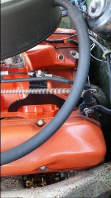

Thanks! Just replaced my 2 barrel with 4 barrel and intake and now it doesn't reach (working on an extension rod). Can you point me to instructions on how to set it up?

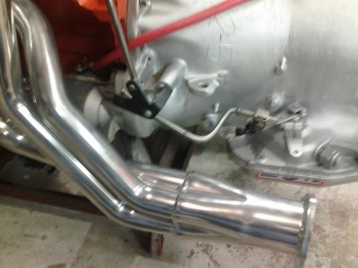

My 2 barrel had the forward end of the slot against the carb connector but pics I've seen has the rear of the slot at carb connector? Here's how I found it:
Try your local hardware store for a threaded sleeve about 2'' long. That's what I did.OR Edelbrock makes one from Summit or Jegs. Your photo is a wrong set up for sure.

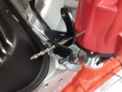

Thanks! Not sure I follow "pin the linkage with a 3/16" drill bit". Do u have a picture?

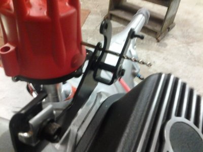

There are holes in the bellcrank which connects the throttle rod to the intermediate rod. Disconnect the intermediate rod, align these holes and insert a 3/16" drill bit.
Do you own a Factory Service Manual?
This is a big block linkage but the adjustment method is the same. You can see the holes in the bellcrank in this photo.

The pic you posted shows the slotted arm and spring in the wrong position. The spring should pull the slotted kickdown lever towards the front of the car. In other words, where the slotted rod goes on to the carb throttle lever, it should be at the back of the slot, so when the carb lever moves, it moves the kickdown rod at the same time. You could go to search, and look for factory service manual. I downloaded one for mine, and it's helped alot.

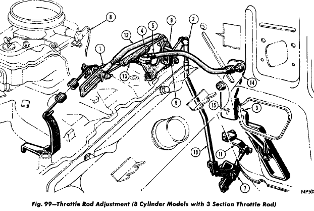

Throttle return spring looks over stretched. Diagram from my mopar 70 service manual. Looks like rod from bell crank is to short. The the pin should be at the other end of slot. Trans will slip!!!!/Burn up.
Throttle return spring looks over stretched. Diagram from my mopar 70 service manual. Looks like rod from bell crank is to short. The the pin should be at the other end of slot. Trans will slip!!!!/Burn up.View attachment 406490
Thanks for the pic. Found the info in the manual. I extended the kickdown rod with (2) 5/16 x 18 couplers, threaded rod, and threaded the original rod the same after cutting it in two. Test drive Tomorrow! Thanks for all the help!
