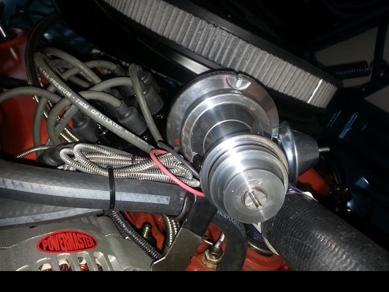

Took a drive in my Coronet this weekend and heard a big snap, then the engine puttered out shortly thereafter. I pulled over and figured my distributor had just gotten a bit loose or something.
Well, after several attempts at adjusting the distributor location I realized I might have a bigger problem. Unscrewed the distributor bracket and she came loose - very loose. The distributor shaft actually snapped in two.
This is a Pertronix Distributor and I've been pretty happy with it thus far. I called them and they are sending me out another.

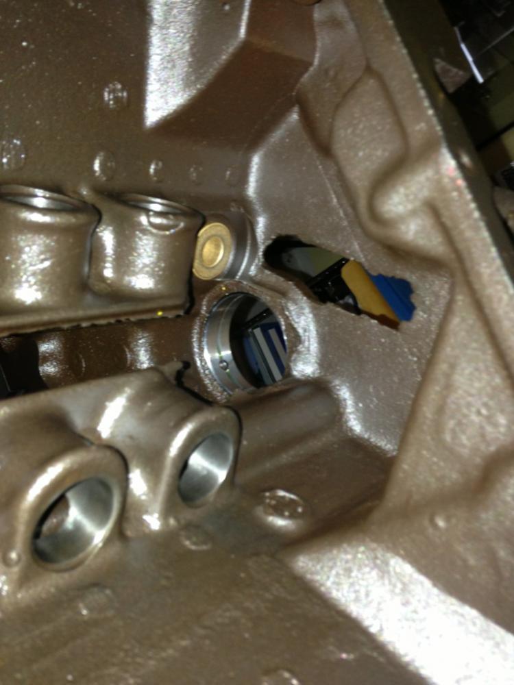

Here's my issue - there is a collar and pin on the shaft and they are no where to be found when I look down in the cam valley.
If you look at this image you can make them out:
Will these things safely make their way down into the oil pan if I can't find them? Would pulling the timing cover help me locate them?

Better pull the intake, valley pan, timing cover & find the parts. Not sure how the bearing/bushing would be able to seize. Be sure to check the oil pump drive too. May need to pull the pan.
I'd begin by removing the intake manifold. Can tell 100% from your picture but it looks like you have a big block??? The temperature sensor looks like its on a small block though.
If you have a B or RB engine the intake is very easy to remove. Unbolt the carb. 8 bolts later its off. No coolant to worry about leaking.
If you are lucky you will find the missing parts laying in the lifter valley. If not, they may have made their way down to the oil pan.
I'd be taking a close look at the oil pump and distributor drive gear too.
The lifter valley will be accessible after the valley pan gasket is removed. In order to remove it, there will be three bolts on each end of the block. These bolts will secure the end rails which look like a flat steel bar.

Chances are very slim that any of these parts will drain out with the oil. Even if they did make it to where the drain plug is located, the drain plug hole would limit the size of the parts that would come out.

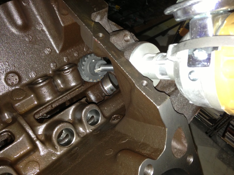

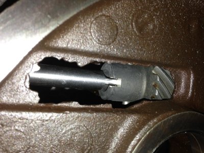

To get a better idea of where the parts went look at a bare block (if you or a friend has one handy) to see the general path.

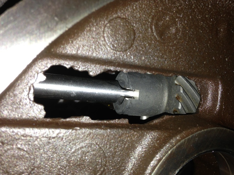

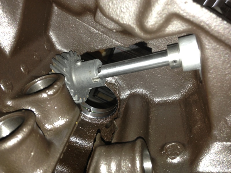

This should help.............. This is my 440 for my 72 SSB that is fresh from the machine shop, but still needs me to get off my butt and put it together..............
The first picture shows the distributor drive bushing. As mentioned above these sometimes wear.

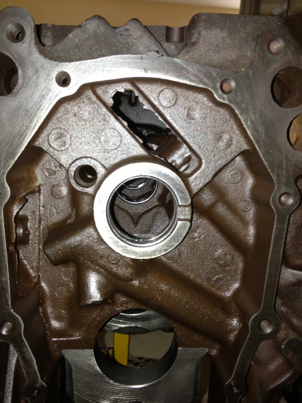

The large open area just behind it leads to the top timing gear / chain.
The open area to the left goes to the camshaft / lifters.
I normally grind off the excess flashing then clean the block real good afterwards.

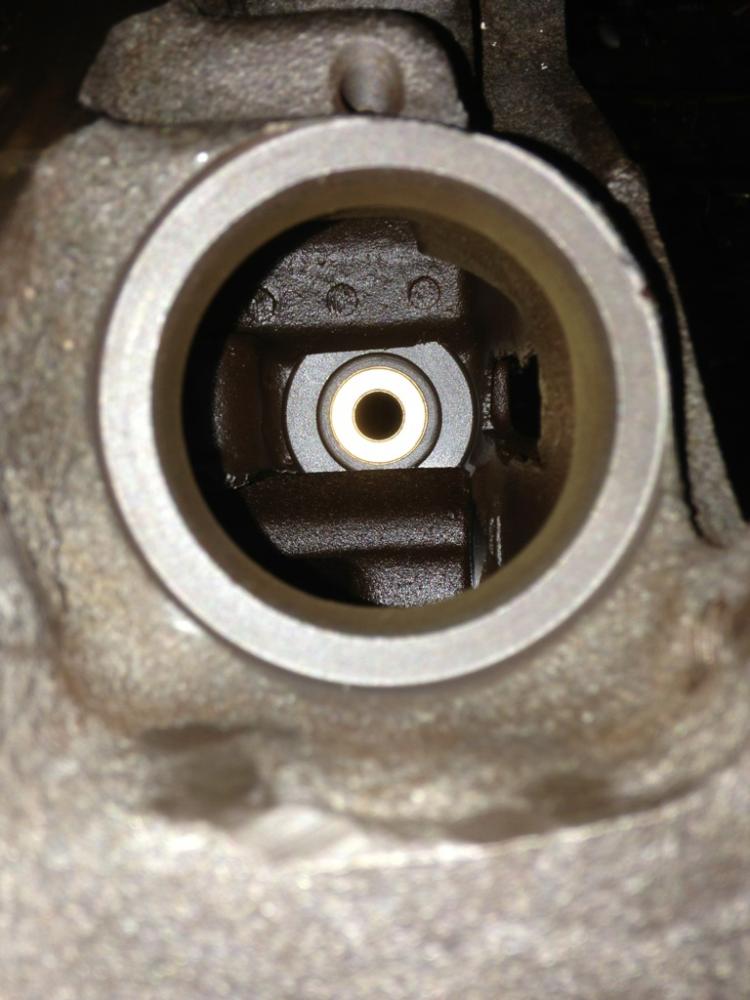

This picture shows the bushing from where the distributor is installed.
This shows the area behind the timing cover. You can see the excess flashing in the top of this picture. This is the area where some of the parts could have gone, but they still will end up in the oil pan most of the time.

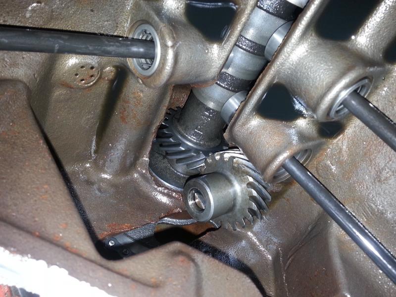

The large open area above the camshaft is where they likely went.
This picture shows everything installed. This is looking from inside the lifter valley area forward.

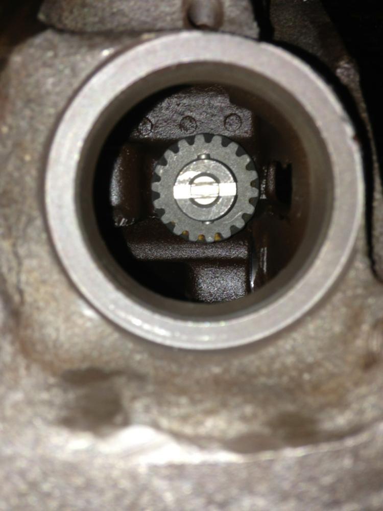

This is a closeup of where the distributor drive gear and bottom of the distributor mesh together. This is probably where your problem started. If it is too tight here it can cause binding.
This is how your distributor drive gear should look when you are ready to reinstall the distributor. Have everything lined up on #1 cylinder firing and make sure the notch is aligned front to back.

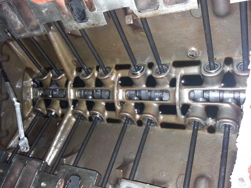

Pulled the intake. Everything looks clean up top. I ran my finger in all oil puddles and didn't see any metal. The distributor gear moved freely up off the camshaft, too.
So can I put the top back together? I suppose I should pull the pan....yuck. I've got a new oil pump gasket on the way so I can check that.
