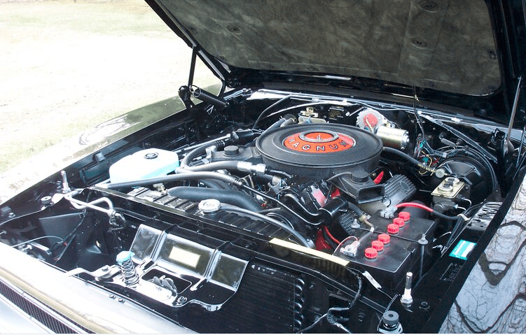

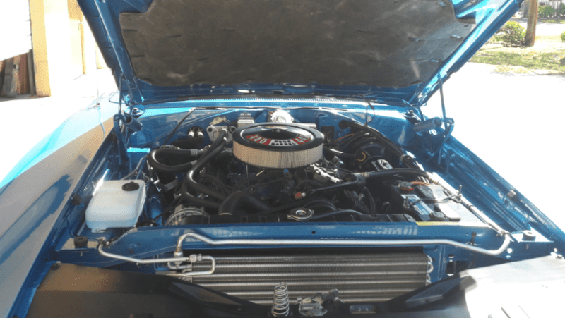

After digging into it I got it wrong.. The condenser appears to be the same, it's only the lines that are different...
68
70
I knew the lines themselves are unique to each individual year and LA versus B/RB engines .
