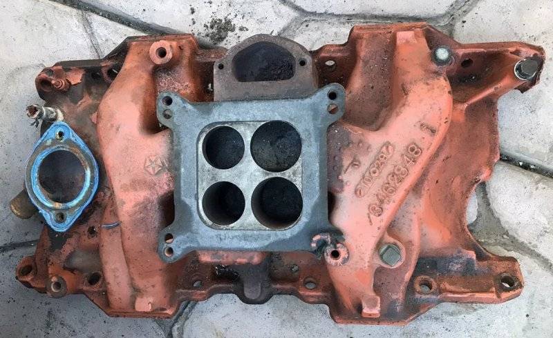

I used a casting number 3462848 (or 2531915?) Dodge 340 intake manifold on my 318 almost 50 years ago. It worked just fine. It is heavy of course. These things go for around $350 on eBay plus around another $100 for shipping. I paid $35 for mine in 1975 and grumbled about it. Anyway, you can probably get an aftermarket aluminum intake from one of the manufacturers for much less than $350. I have no suggestions on which aftermarket intake to use, nor any suggestions for a carb. Well, other than pick a carb with around 550 plus/minus 50 cfm and go towards the low side.

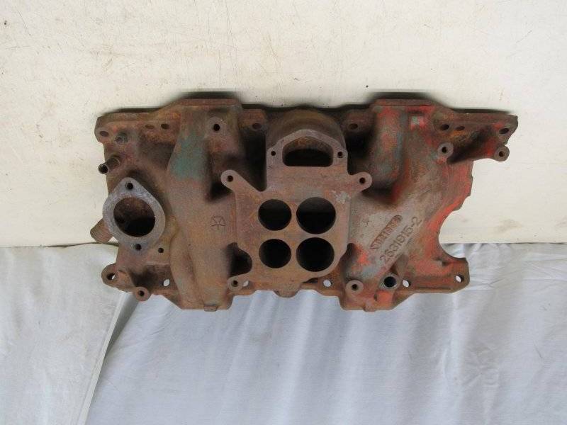

IIRC an native intake for that is not even made.
Square bore Edelbrock 4 barrel intakes, OTOH can be had at swap meets for about $100.
