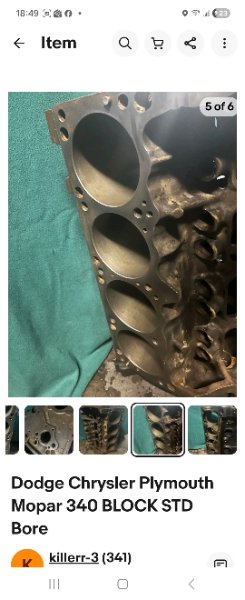

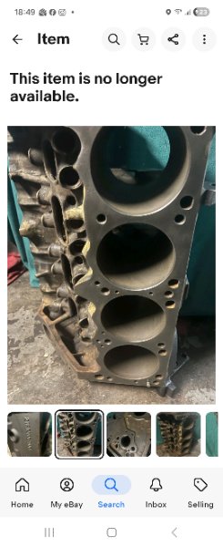

I recently bought a 340 block stand bore. Hone not bored. The cylinders wall look great at 4.042. Now is there any way to find out what car the original block came from by using the partial vin # 127282. And next question is should I just stroke it has it is to make a 392. Or just have it bored to 30 over to make a 416. As I can tell they both will create about 425 to 475 hp pretty easily. Thoughts?

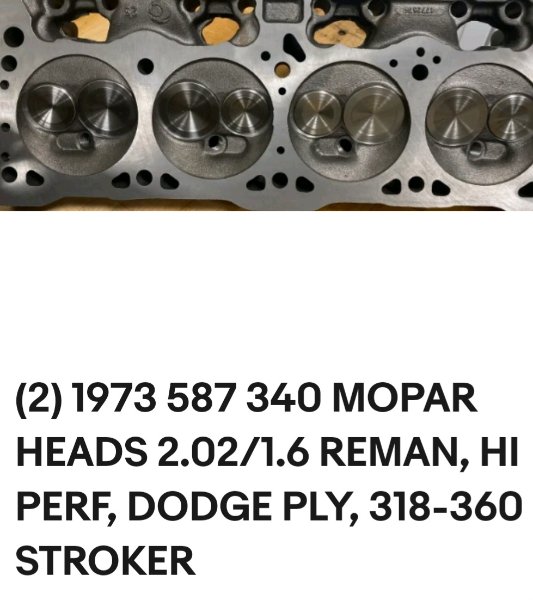

I wanted it to look pretty much stock. So I had a machines get me two 73 heads and put 2.02 intakes and 1.6 exhaust valves to make like the x heads made the chambers 68cc

I wanted it to look pretty much stock. So I had a machines get me two 73 heads and put 2.02 intakes and 1.6 exhaust valves to make like the x heads made the chambers 68ccView attachment 1947245

I talk with the guy after seeing he was selling reconditioned 915 heads. I told himi wanted to use stock heads for a 73 series. Which is 587 heads. He suggested to upgrade to the 2.02 valves. I showed him the stroker kit I was puting in and asked him to make them 68Cc so I would have 9.7 compression in the cylinders by the documentation. He said he could. The cost is 1000 dollars per set. I will take pictures and put them on the site when they arrive on monday. I will also check the cc for the actual size. If you want I can give his number if any one is interested.

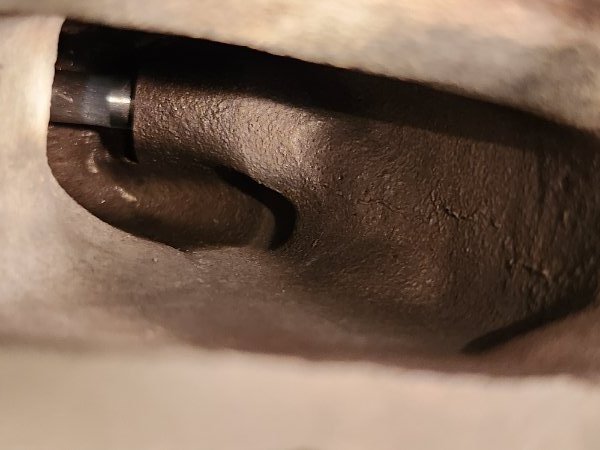

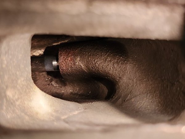

I have some pics of one head that came today. Iwater tested them cc them at 65.her a few pic of the intake side not polished by pretty clean air flow to cylinders.
