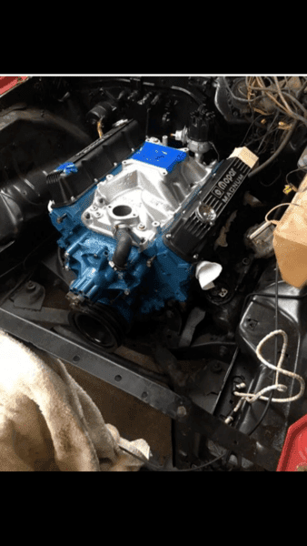

With the low horsepower goals, you can get a running Magnum 360, don't even remove the heads, just upgrade the cam and valve springs staying within the lift limits, keep stock lifters, put your LA fuel pump eccentric, front cover, and pulleys from your LA 318, the chinese air gap manifold because it has the correct LA thermostat size and position, and you end at your goals very cheap. There is still small stuff like motor mounts and flex plate, but those are easy answers. The easy alternative, if you are stuck on wanting an LA, is to just do a low buck rebuild on your 318 since you already know it's a good core. Nothing wrong with a 318 in that power range. I would do the Magnum though, if you don't care about the original block staying in the car.
I went with magnum heads (among cam/intake) on my LA build. 411 HP
