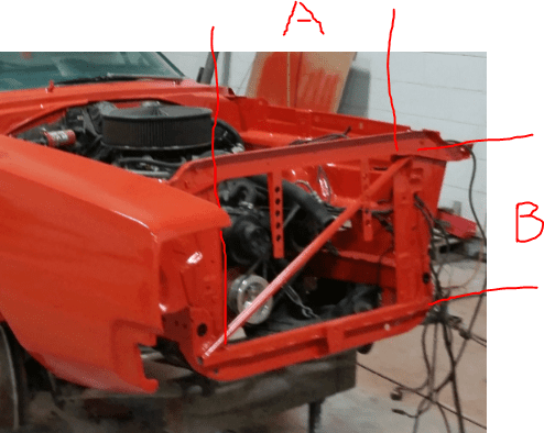

where is the 26 In. measurement you're referring to. below is really only decent photo i have of mine.
or is the 26" referring to the bolt hole centers ?

Good news is you have a 26" radiator support. So that makes your swap pretty simple fitment wise and pretty high probability of having plenty of cooling potential.

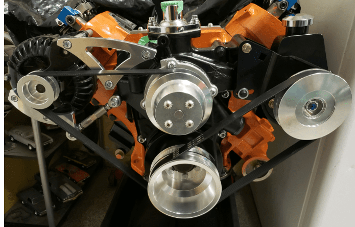

Are you going to run a pulley system on the new motor or original pulleys and mechanical water pump?
i got 440 sources serpentine pulley set up

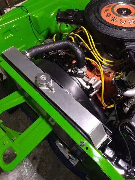

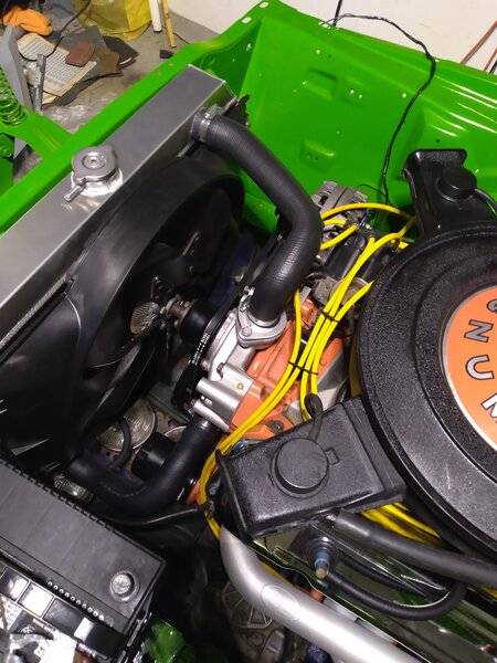

I went with this route last year.
https://www.ebay.com/itm/392277934001
Killer price and 5yr warranty. Its a 71 air car, running non air currently but can add air down the road as inlet and outlet are set up for it.
