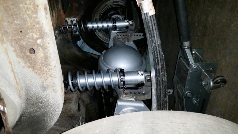

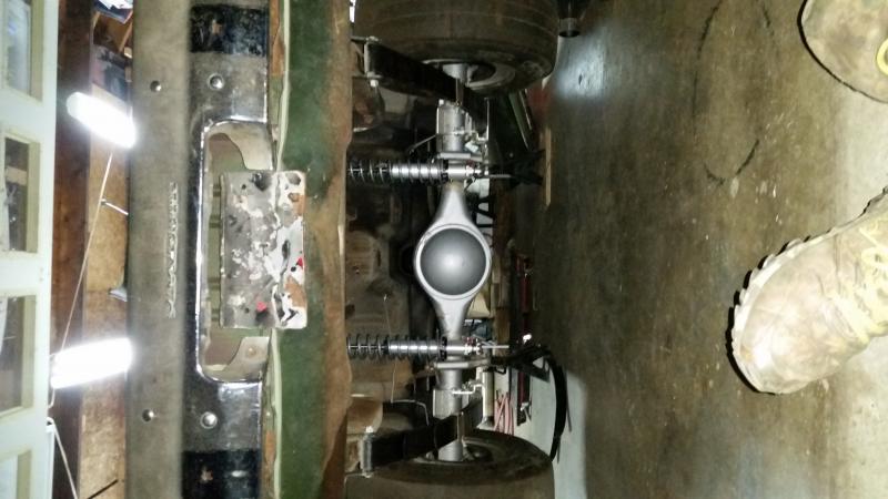

Well, I installed the leaf spring relocation kit on my 73 roadrunner.
The rear is a 67 belvedere 8.75 posi with 4:11 read gears.
Installed ladder bars and also the axle floater kit.
The leaf springs are as follows ;
6 leafs passenger side
5 leafs drivers side
Also installed is a set of double adjustable strange coilovers with 14” 90 lbs. Springs.
The problem I'm having is the rear is sitting to high.
I have tried all options to get it to sit lower but only to fail.
I know that I could ditch the leafs and floaters and install a panhard bar. But that isn't what I'm going for.
I think I have 2 other options.
Have the springs de arched a couple inches
OR
remove all but a couple leafs out of each leaf pack. Either way it would put more of the weight on the coilovers and lower the stance
I am going for the old school ladder bar look.
Basically only using the leafs as a locator.
I know I'm not the only one that has done or is doing this.
And no , I am not interested in a cal tracks or 4 links
Any help would be appreciated
Thanks in advance
Car will be a street car and will be raced

My idea at this point is to take apart the leaf packs and re install the single main leaf , using the 90 lbs. Springs on my coilovers. I have a set of QA1 130s but figured they were to stiff so I got a set of 90lbs. Eibachs .
And I was wrong in my one post. I have 6 leafs on one and 7 on the other. Pretty stiff springs
Yes I have for in an early gm car. So I get what your saying their cranky. I'm not real find out the feal of the shimmy on a hard launch
Well, I've gotten it down to a single leaf on each side and the more I look at it the more I am realizing that I don't like the leafs. So looks like I'm getting rid of them. Gonna get a track locator. Wasted $ on the axle floater kit and time installing it. Oh well , live and learn.

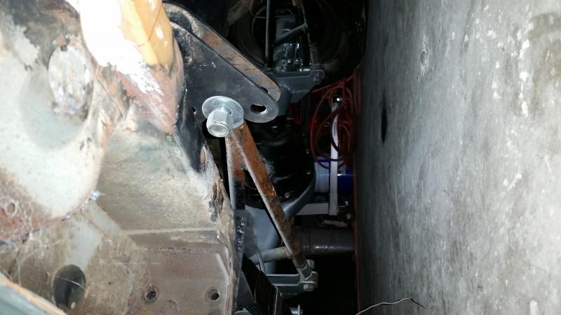

Well I will tell you what. That shock crossmember was never meant to support the weight of the car. It may hold for a while. It may hold for a long time. Or it may let go on the first big bump you drive over. Braced to the frame rails will help. Tieing it to a roll bar from right over where the shocks mount with 1 5/8 tubing would work well. And put that upper mount bolts in double shear. And the correct shanks on the bolts.
hangOut makes an important point, bracing and/or boxing the stock shock mount or replacing it with a good tubing mount is probably required.
I agree on reinforcing or adding the shock cross member. I would not ditch the leaf springs on the street. Track locator on the street isn't a good idea. Thin cross section and the ladders have no give for body roll. Track locators are easily bent or worse broken in street use. Here's a pic my upper shock mount.

Thanks for the pics dvw, I cut out the original upper shock mount and welded in the same coilover shock mount as you did.
I am down to 2 long leafs on each side. That got my rear down a good bit and put more weight on my coilovers. I'd like to get it down just a little more so I'm thinking of cutting out 1 more leaf , that would leaf one leaf left. I wanted to get rid of the leafs all together but everyone keeps telling me to leave them for street use. It just looks like over kill with 2 suspensions.
The leafs will do a good job of keeping the housing located. You could use a lighter coil spring to lower the rear. How far is the shock compressed with the weight on the rear?
Doug
I have roughly 3/4 an inch between coils with full weight at ride height. Wheel well lip is roughly 1 inch above tire. Thinking about cutting one more leaf out, leaving one leaf per side . That should drop it a little more
