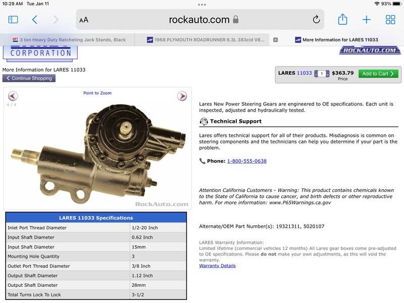

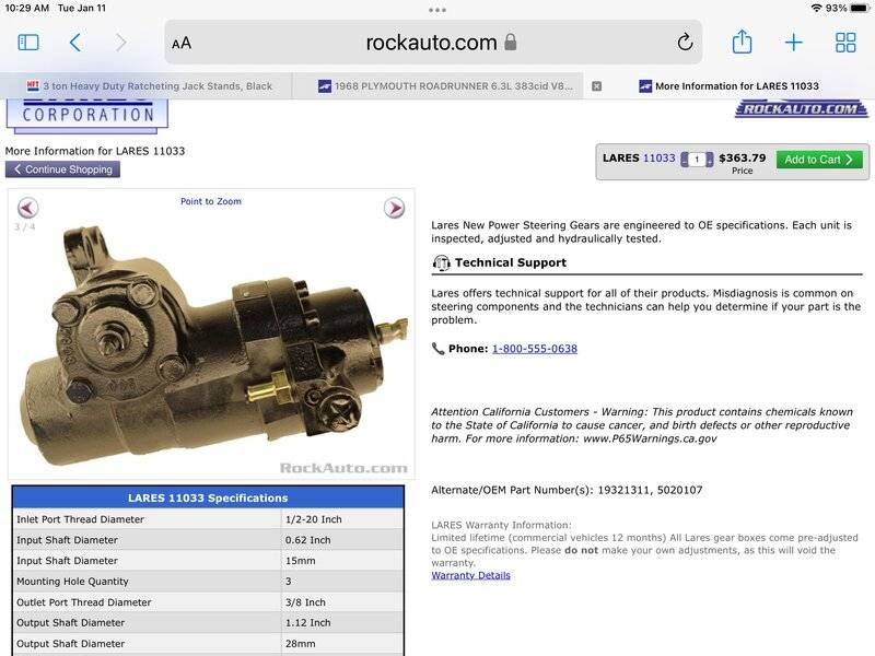

I opened it up and it is similar to my oe roadrunner box, but the inlet and outlet for fluid are in a slightly different spot, and it does not have what I’ll call the “centering valve “ the oe has on top with the pressure and return fittings.

I just added pics from the Rockauto site of the 11033 steering gear. It does not have the valve on top to center the steering wheel. I don’t believe the Borgeson box has the valve, either. Different design from the oe !!

I have not had any experience with the lares one you posted. It definitely looks different than the normal one that came on these cars. Maybe call their hotline number and speak with someone about it and see what they say?
