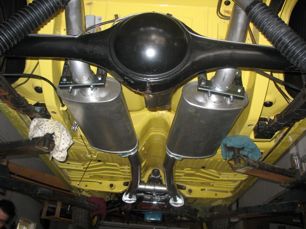

I have a 69 roadrunner and I am running headers with 3 inch collectors and pipes with a crossover pipe ran through a pair of Dynomax turbo mufflers with turndowns at the rear axle. I am contemplating running the exhaust all the way out to the rear bumper and installing some 3 inch road runner stlyle tips I have spotted on ebay. I have an electric fuel pump and filter mounted onto the inside frame rail on the passenger side.
I am curious as to whether any of you performance minded Moparites are running large diameter exhuast and if any problems exist. Thanks!!!

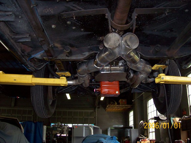

You didn't indicate what performance level you are at.I have a 4 inch stainless system with "X" pipe.It's real nice not havin' fumes come into the car from turndowns at the axel!!
Thanks HEMI-ITIS! My roadrunner has only been on 1/8 tracks and it is good for 6.90's We drive it hundreds of miles on our outings so the fumes are a problem. That is a great looking Beast you have there I might add!!!!

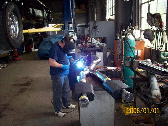

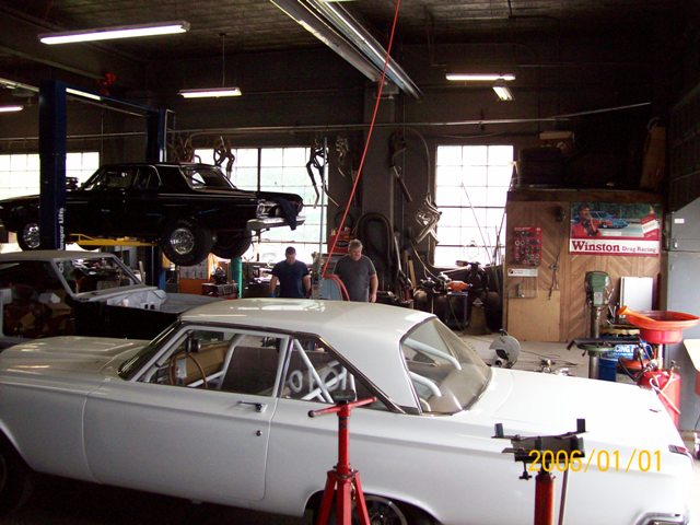

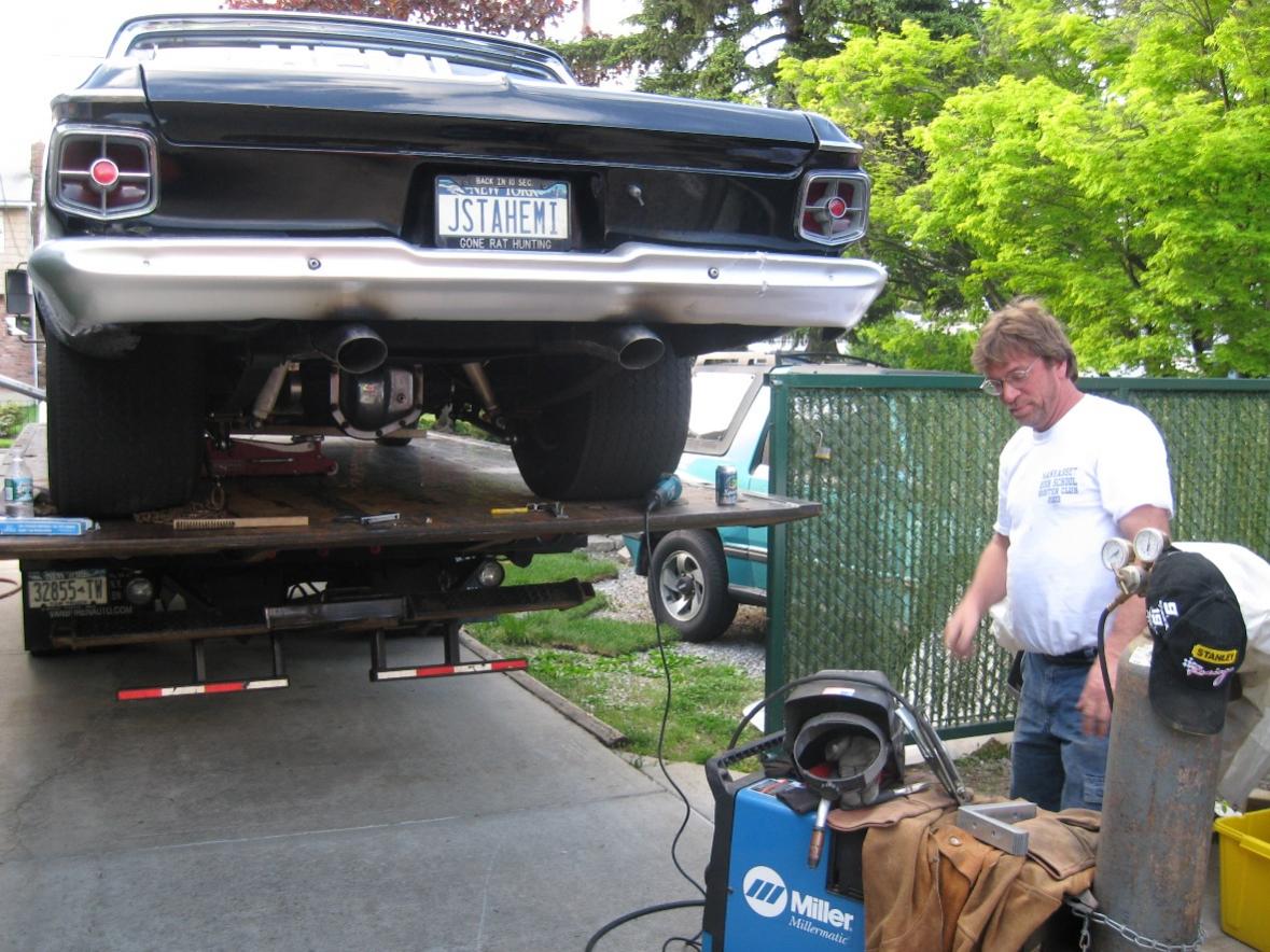

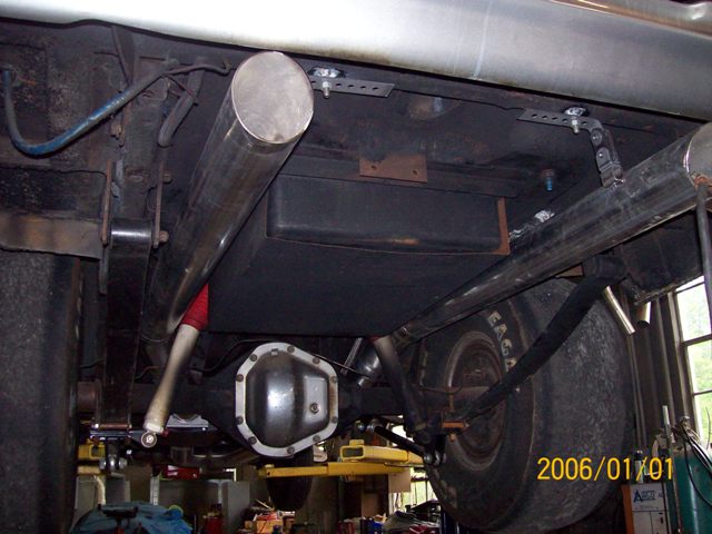

I had a 3.5 system before the 4 inch.The exhaust was pretty muffled,but I love the way the sounds with the "X" pipe.You can barley hear my street car at the track next to the race cars.But once I "GIT GOIN" it might get your attention:icon_hang::sleepy2:

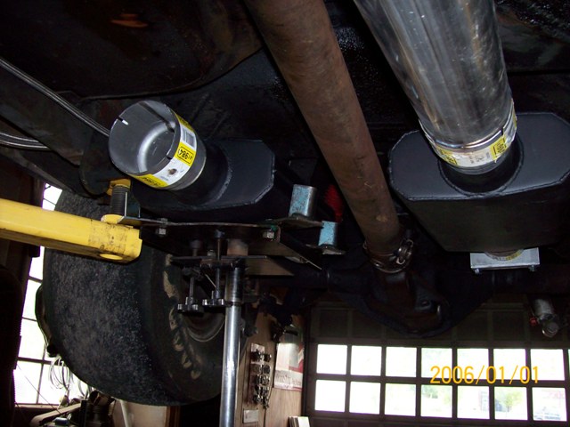

I,m running a TTI exhaust,2" headers into 3" exhaust to the tips,no problems in fitment.Did have to install a torque strap as the collector was tapping the cross member.
