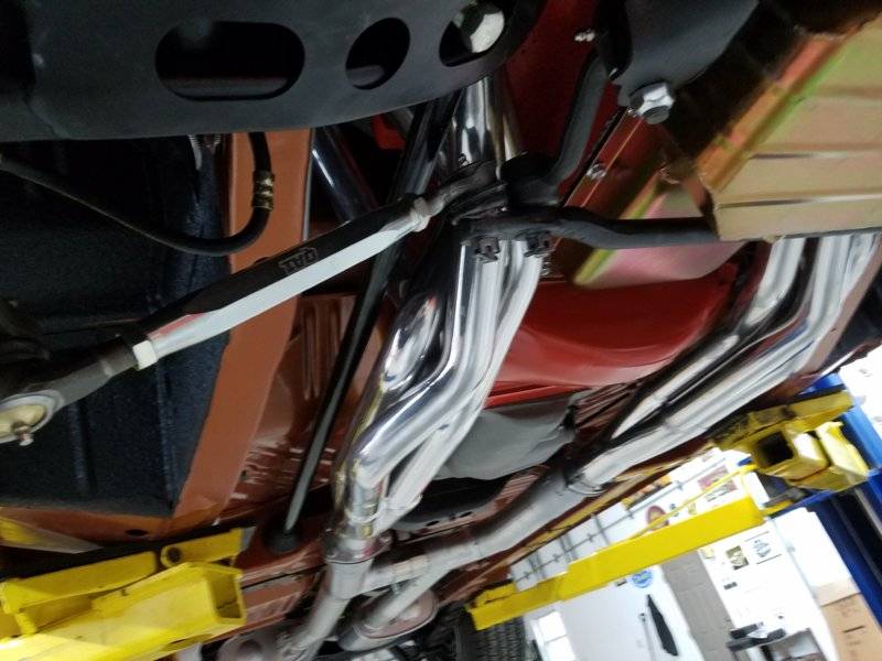

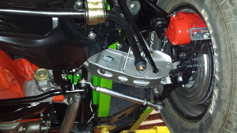

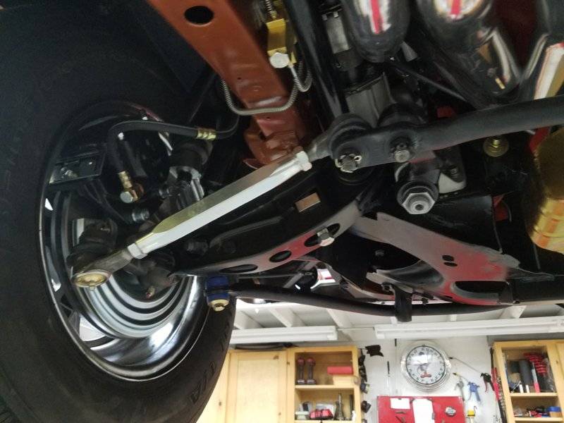

I just installed 11/16" C body tie rods and sleeves on my 69 Bee. Haven't driven it yet, but they sure a lot more robust than the factory set up.
