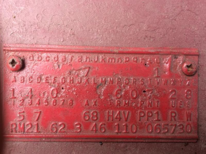

Trying to figure out the last code that shows as unknown on my '68 Roadrunner.
I think the rest of the codes I have a good idea on but feel free to comment on any.
My problem is C-4.
2 door coupe
383 4bbl HP
4-speed 833
Jan, 10th 1968?
F70x14 whitewall steel
3.54/3.55 Dana / 8&3/4 Suregrip
High trim grade
Vinyl split bench
Interior - White, Red
Monotone Red roof and body,
Burgundy metallic door frame w/ white pin stripe
26" radiator
Decor package
rear speaker
am+8-track player
Tachometer
Tinted windshield
roadrunner hood
hood/fender turn signals
drip rail moldings
B-pillar moldings
Sold car when built *ordered*
But what is C4? Thanks!
Heavy duty suspension with sway bar. C is for suspension. 4 is for code 624 which is the above. Does this match up to your car?
Typically found on STL built RM21 cars up until about the time the RM23 cars came out ~ mid January.
Yes I believe that is the correct code as it seems to match the suspension, Thanks! I wasn't sure but that cleared it up quick!
