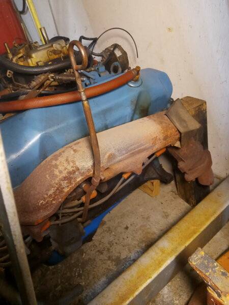

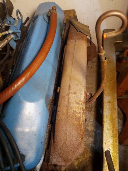

Curious if these would fit my 71 B body...anybody ever try or know off hand? They look kinda close. Not sure of the positioning where the exhaust angles down/out if it would hit the torsion bar, frame rail firewall etc. Would be nice if so I can just clean it up and put it in and finally get on the road this summer. I don't mind putting in the time and work down the road for headers etc. Thanks in advance!.
20210220_000548.jpg 20210220_000508.jpg View attachment 1071965 View attachment 1071966
Chrysler didn't make different ones for C bodies without a reason. Better look closely or else find the right ones before jumping into a problem....
I think the exit on the driver's side 2 willl hit the column on a 71. But I think they put those in the 75 and newer bb b bodies...
Also the outlet is sized like a log and not as big as a hp manifold, even though they are similiar looking.
