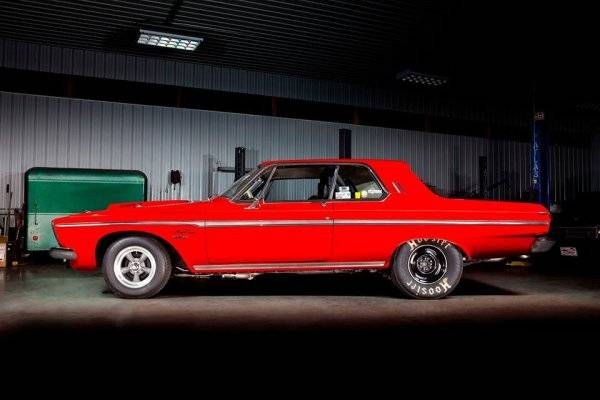

I run the standard 55" SS springs on my 63. They are the 3400 lb rated ones I bought from Mancini. This how it sits and how they fit as these are the same size (lenth) as the A-body 002-003 springs on my sons 72 Dart. Ron
