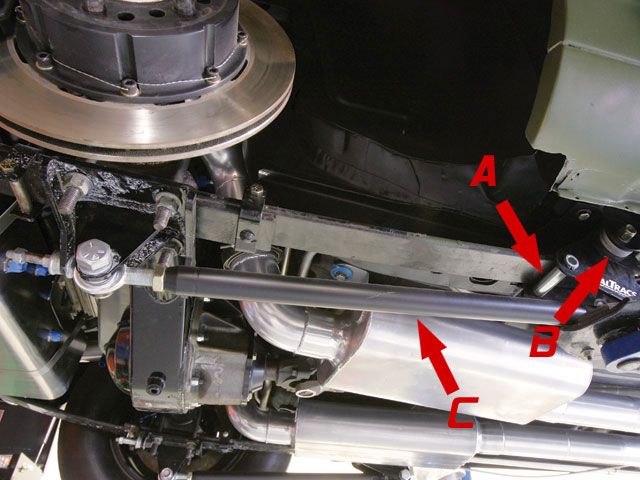

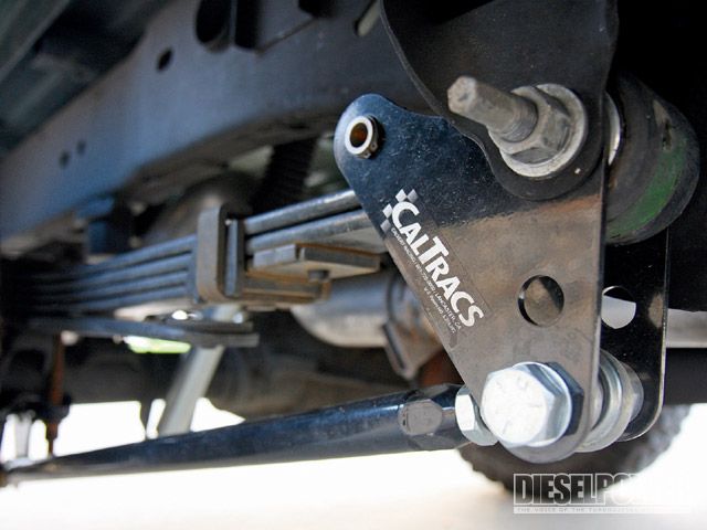

Am I missing something here? It looks as though the bar (point 'A' in your photo) is underneath the leaf spring. Isn't it supposed to go on top?
Yep good point, it was late and I googled for a pic, didn't bother to study it.
How about we use that pic as a reference on how not to fit them, oh......it was on a chev, who knows maybe he likes doing burnouts in reverse, maybe it's how they do things over in the GM camp.
Anyway,here's one on how to.....

Was about to say those are some healthy leaf springs, then saw the shocks and 'Diesel Power" logo in the corner of the pic. Got a Cummins myself.

SandDiesel, I did a double take too and looked at where the spring was going before seeing the watermark lol
