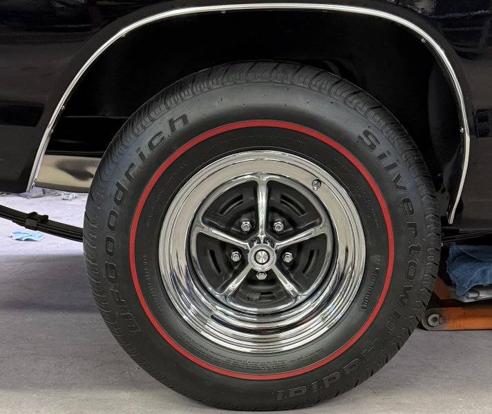

I have a 1969 Dodge coronet Super Bee.
I bought it as a basket case and didn’t get leaf springs with it. I have now finally put suspension underneath of it.
I bought new Mopar leaf Springs made in Mexico
They have six leaves on the left side and seven on the right side. The problem is the car sits high and the rear end is forward in the wheel well closer to the front of the car then the back. Is there a good place to buy Springs to get the factory ride height The way they it should fit?
Thanks for any input

Thanks for any inputView attachment 1923744

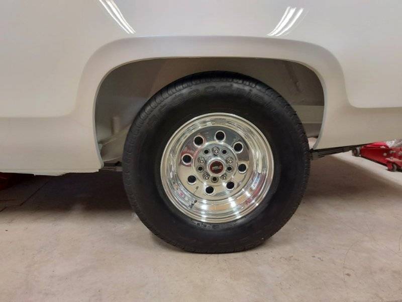

I tried using super stock mounts on regular leaf springs - big mistake as the I got the opposite of the OP's issue - my rim & tire was further back in the wheel opening.
Here's what it looked like....DOH!
Closer to the front is normal. I think you are lucky. Years ago I ordered the same springs for our Charger. Old ones were sagged. New ones came, installed them and car dropped about another 3/4”. No warranty because of the letters in front of part number. Factory rep was supposed to meet me twice. No show. Dealer just said here is a refund cheque, keep the springs. They might have been put on a drag car later, not sure.
I have about 3/4-1 inch clearance in front the tire and bottom edge of the rocker. 275x60R x15x8. I have 215x75Rx15x7 on the front.
I would have been happy if I had your problem. Can you raise your front end? Or purchase a pair of taller tires for the front. I know that I personally would not go wider than 225’s on the front.
I think RemCharger has 295x50x15 on his Charger. Factory springs.
Hope it works out.
