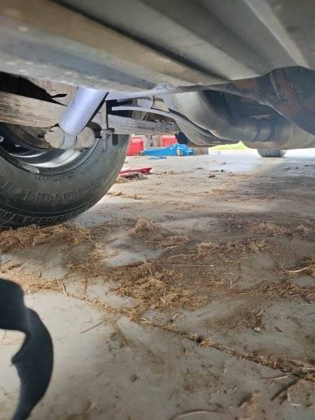

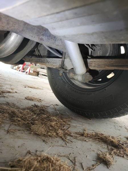

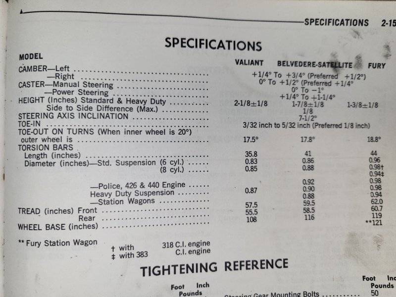

The right side leaf was stronger than the left but I never noticed a difference in height but really wasn't looking for it. IF it bothers you, take out one of the leafs or crank up the LF bar a bit more. If you're using the car for some street action or drag racing, it'll help more than hurt. What I used to do when I didn't have a SureGrip is ran 10-15 psi in the right side air shock along with cranking up the LF bar a turn. On the street, most thought the car had a SG in it. Ran about 5 psi in the left just so the bag would last.Ok, so I installed new leaf spring front hangers with the front eye in the 1" lowering spot.

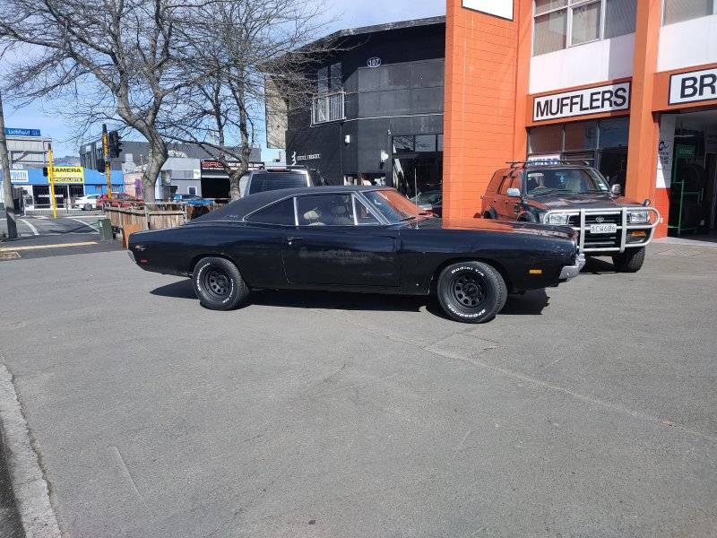

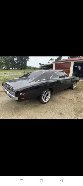

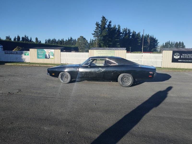

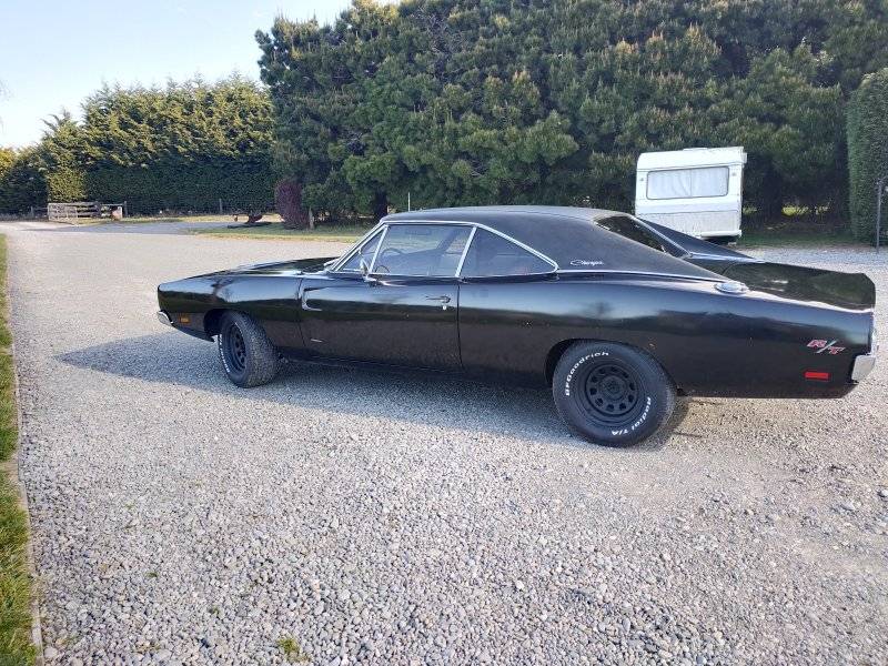

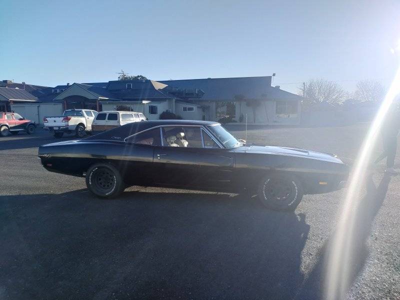

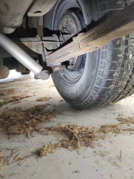

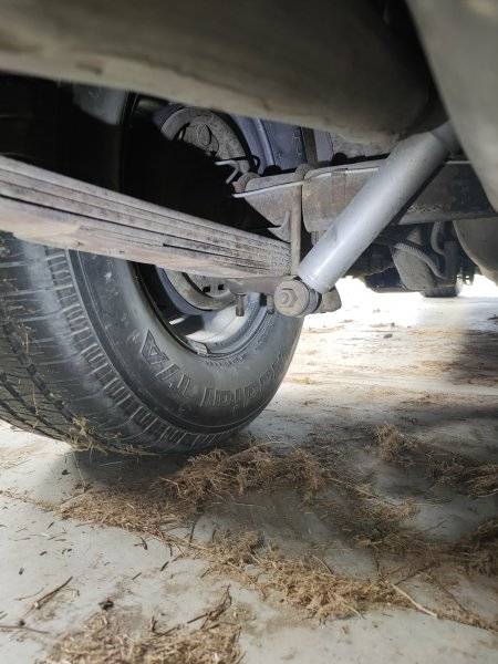

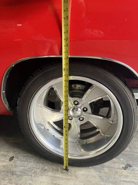

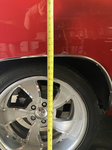

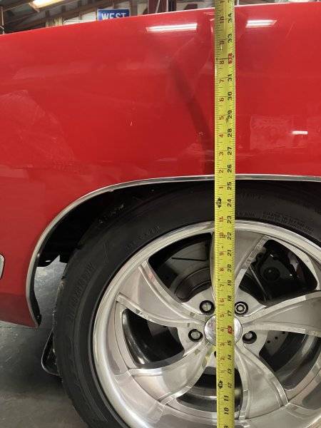

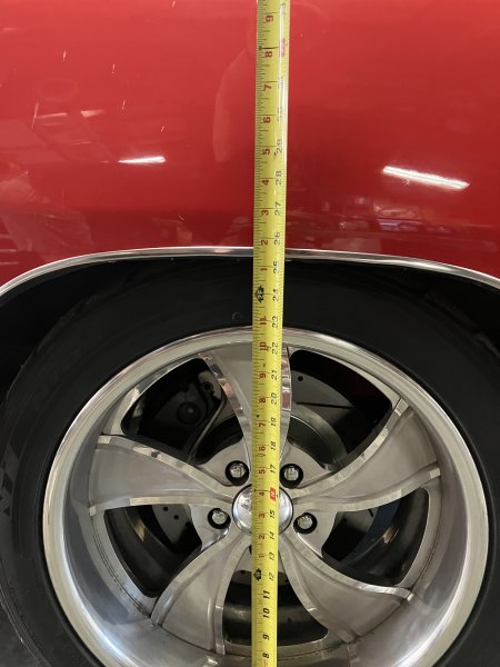

Left side looks great but the right is still sitting up higher than the left. It's about 3/4" diffetence. Just enough for me to notice it!
The right spring has an extra leaf as it is an r/t model. I have read that this was normal for the r/t models but Is it normal for the right side to sit higher than the left? Or has the left spring just sagged.as they look to be original springs?
I am thinking about putting a 1/2" lowering block in the right side to bring it closer to the left.
