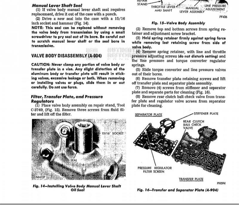

Couple ways you can do it......
From the top or from the bottom. Neither require the tranny to be dropped.
Here's the "how to" from the FSM (requires dropping the pan):

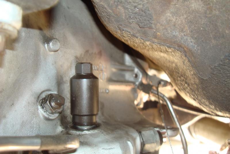

There's also a tool made to pull the seal from the top, without having to drop the pan:
http://www.ebay.com/itm/Chrysler-Shift-Lever-Seal-Remover-Installer-1960-2002-T-1031-A-KD-2392-/281056210835
Some are able to fish the seal out with a pic style or small screwdriver, and then drive the new seal in with a 15/16" socket.....But be careful not to scratch or damage the shaft. Be aware there is two seals. An outer larger seal (which is typically the culprit) and a smaller kickdown inner seal.
