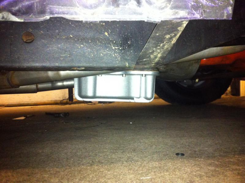

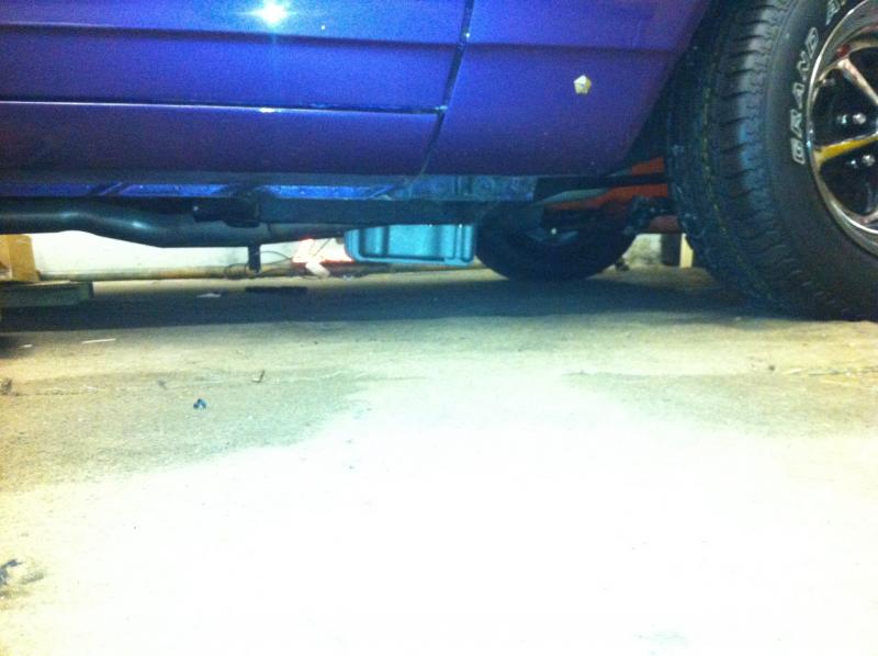

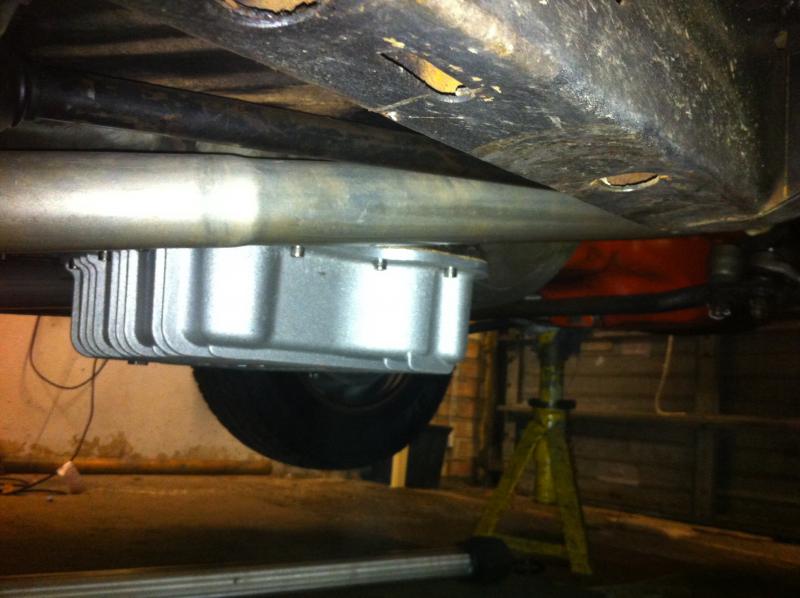

Wow. Identical problem to what I'm encountering now. Exactly the same as you. Lowered at the front with smaller tires than the rear. I bought a B&M aluminium pan cos I could not get my original to stop leaking no matter what I did.
Unfortunately this was the smallest pan I could get from summits, supposed to be 2 quart extra but the thing hangs lower than a snakes testicles. Only just fitted it tonight and it's no good. So will be interested to see what replies you get as to our options. You can see from the pics exactly just how low it hangs.
4" deep pan leaves me 3.5" ground clearance. You must be able to get a stock sized pan in aluminium from somewhere ?????????
