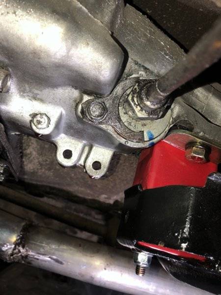

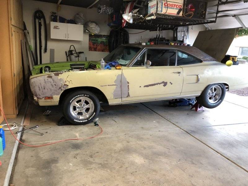

I did mine last night. Lost a full quart on the floor so be ready fir that to happen. I had the back end up too! Pic before removal.
