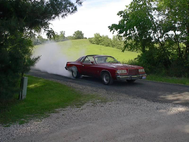

My experience has been on 3 cars.
1st. experience: 79 Magnum w/318. Was from a car w/points, so maybe didn't realize a big difference, but it did idle better.
2nd. 78 Magnum 360-2. This one had the original LB computer, and it was almost 30 years old. Ran fine, but was hard to start when setting for extended periods, this car would set through the winter. Performance was slightly better and mileage dropped maybe 1 or 2 mpg's. I drove this car to Carlisle many times, through W.Va., Virginia, Penn. Major hills on the way, and would run 65-70 all the way. Would get 20 mpg's w/LB, dropped under w/ elect. ign.
3rd. 78 Magnum, 360-2. Partial change here. I changed the carb, and distributor to elect. ign. type (vacuum adv. style), leanburn electronics still in place. Before the carb/dist. change, this car wouldn't squeel tires if you picked it up and dropped it. Now, with the changes I made, it runs 180 degrees better, mileage is better, performance is light-years ahead of where it was, and will light up the tires w/o effort.
Is that your car in red ? If so, I love that car in that color, esp w/ white interior ?
Thanks!! yep, she's red with white gut. Might change it over to tan just for something different.
Oh, when I bought my black 78 new (360-2), salesguy said I'd get over 20, I laughed. I, more than once got over 22 mpg's.
Nooo ! Don't mess with beauty, that red/white combo ! I had a black 360-2 Cordoba back in '77, would get about 20 hwy...
