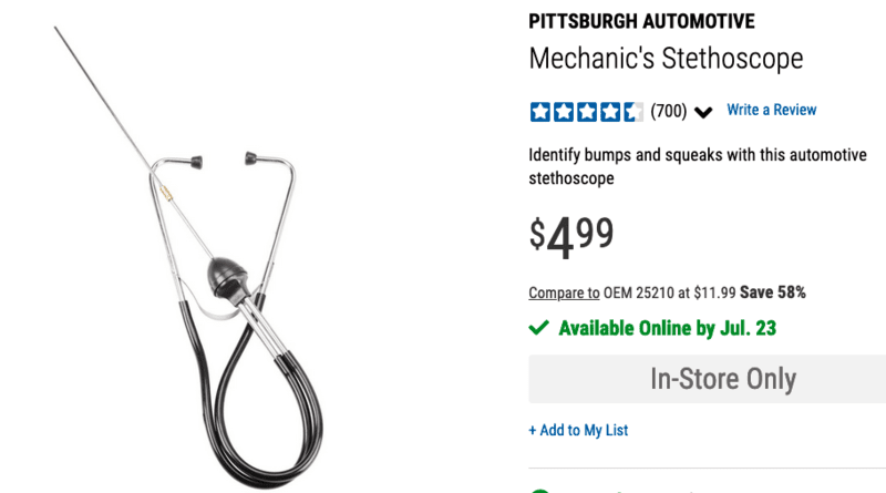

I squirt ATF in the carb & look for the smoke coming from the leak.
Yep I started doing that in the 70's. Works good. Ron
I would pull the metal part off and use that with just the hose. Ron
I agree - I have one of those and that metal tube touched to any part of the engine (or drivetrain) just transmits all sorts of racket from everywhere. It needs at least a piece of rubber tubing over the end of it.
