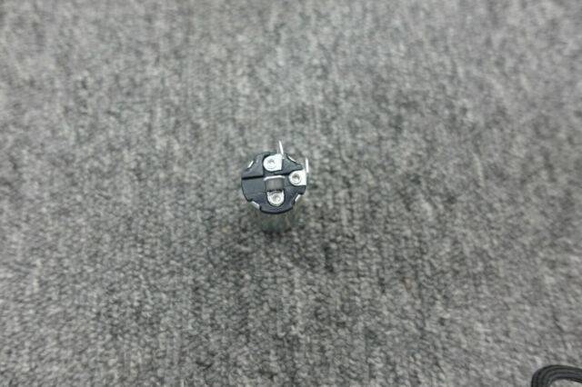

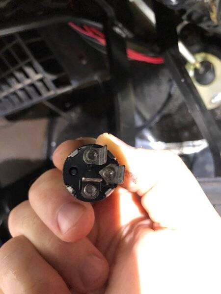

Picture below is the original flasher (68 Coronet 440). Every electronic flasher I have looked at is no where near the blade pattern here. Even a two blade replacement looks as though it would not fit. Anyone have the right part number?
That looks like a time delay can to me and not the flasher. I changed my lighting to led and found one of the flashers attached to the ash tray.
looks like a starter and ignition switch lamp time delay relay
Got it. Most likely the reason a flasher would not fit. Thanks for the help.
