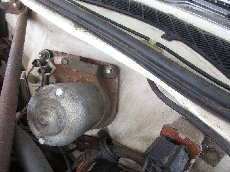

Motor on firewall.

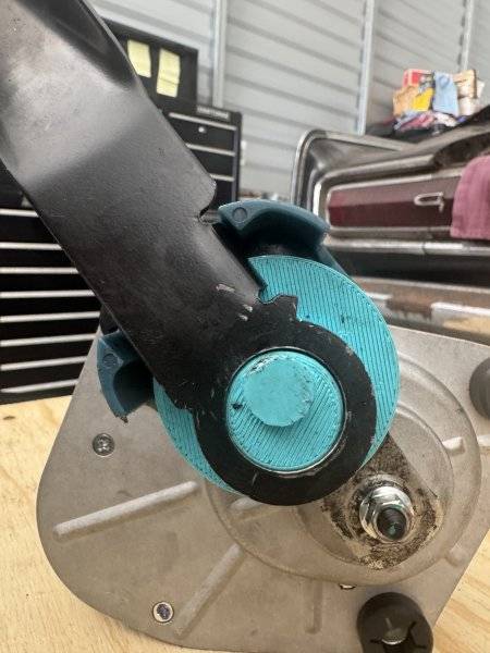

			The slot in the arm goes onto the plastic circle, with the arm IN THE NOTCH BETWEEN THE TWO RAISED EDGES OF THE DARK BLUE PIECE. In between the 10 o'clock and noon position on your pic. Now: you may have difficulty snapping the hole over the circle ( I had to s-l-o-w-l-y ream the hole out s-l-i-g-h-t-l-y in order to snap the hole onto it. )
Yes.
Awesome ! You're welcome, glad to be of help.Thanks. Got it working!
I very much appreciate your time and efforts on this.
