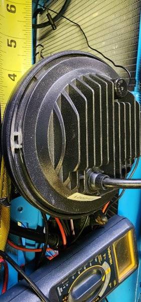

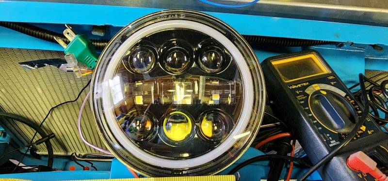

In progress.
You can see the nub that has to be removed.
