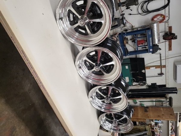

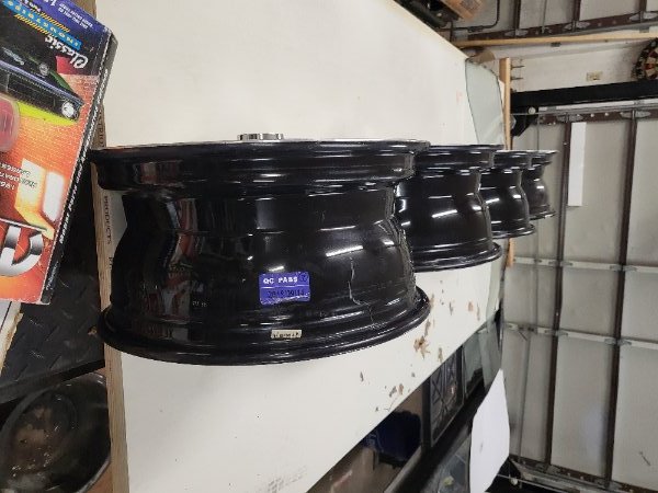

I bought 4 15x7 legendary wheels from a friend I haven't used them yet and quality looks good bolt on bullseye caps on these and legendary caps are press on

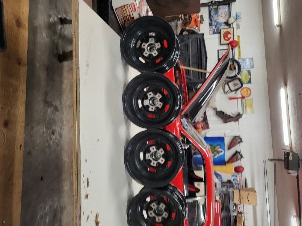

I have a set of 15x7 aluminum Magnum 500 style rims on my 1964 Polara. I don't know whether they are ones being discussed, so I will post a picture. I had trouble mounting them, and found they were hanging up on the splined part of the wheel stud that extended through the brake drum. The stud holes were not chamfered on the back of the rims. I relieved this area with a step drill, and the rims went on fine. Tires and rims balanced fine, and they look great. The centre caps are plastic push-ons. These wheels look like the 1969 style that had a trim ring. I have seen others that resemble '67-'68 style with chrome rim. These have been clear powder coated, so they retain their shine.
