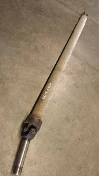

i dont need to know how to measurer a drive shaft. I need to know if any one knows the length of a 65 Belvedere drive shaft. I have changed out my old 904 cast iron with trunion and put a big block 727 in my 62 Fury. Joe Suchy told me i need a driveshaft out of a 65 Belvedere or Satellite. i have people out of town that have driveshafts but we need the length. I do not have a yoke or drive shaft at this time. All the charts seem to start at 1966.
I have one that I am going to put in my 65 Belvedere (swapping to big block). It is in storage so I will have to look for it, but I think it was 55 1/2". Will let you know the exact length when I look.
Went out and measured driveshaft for my '65 Belvedere with big block 727. From center of the rear U joint to center of front U joint for slip yoke is 53 1/2". Hopes this helps.
I have one from a 65 BB 727 Belvedere. 53.5"
