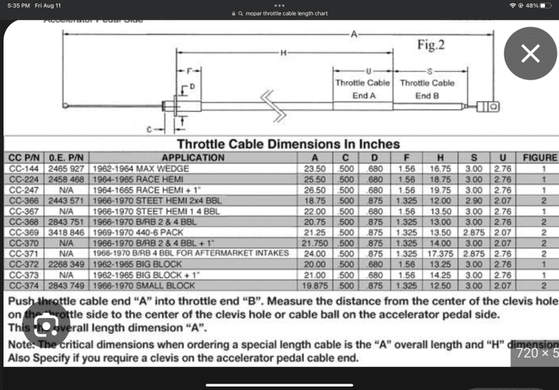

Wanting to know length of original Mopar factory accelerator cable 1968 B Body hemi car with 426 engine/automatic transmission. Bob Horman

Thanks Bee, I knew I'd seen that before too and tried to find it but couldn't. Seems like it used to be on Mancini's site?
Do you have the source for that chart?
I've saved your image for future reference but my curious side has to know where it's found or I won't be able to sleep:lol:
