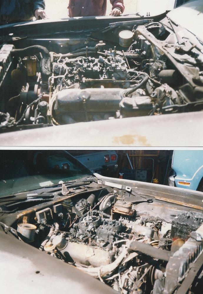

Here are some pics of my dumbass experience from 25 years ago when the valley pan filled up with fuel because I was a dumbass. And dumbass didn't have a fire extinguisher. Don't be a dumbass.
