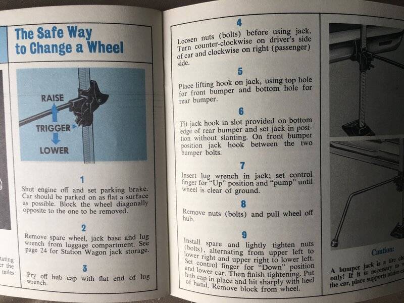

SORRY to ask but I am finding conflicting info everywhere. Our 64 Sport Fury has RH threaded lugs on the right (passenger side) but the owners manual makes it sound like the RH threads should be on the driver side. Most internet "experts" say the LH threads on left and RH threads on right. I don't need an explanation why - we just want to know what the car would have had when delivered new. Thanks!!!

Left hand is always on the left side.
That seems to be the consensus. The original owners manual says to turn the lugnuts on the passenger side CLOCKWISE to loosen.
Thats either a misprint, or simply wrong. Left hand threads on the drivers side (assuming you are NOT in australia), right hand threads on the right.
There was an engineering reason, to keep the left side lugs from loosening. Chrysler did that from at least pre-33, till somewhere in the mid seventies.
Lots of cars have been changed, however, because lots of tire jockeys dont know any better, and bust the left side studs with their air guns.

Every older Mopar I've had.....left on the left. Wouldn't make sense to have them on the right.
