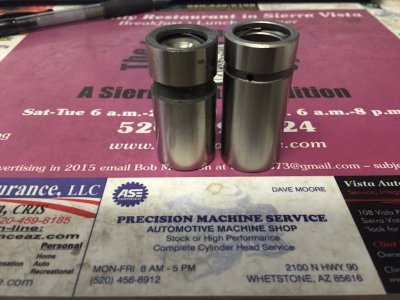

can someone either post a pic or explain the physical differences between a big block and a small block hydraulic flat tappet lifter?

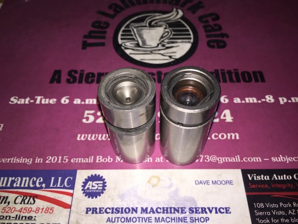

Seat height, lifter height, and any outside grooves for oiling on the lifter body. The lifter on the left is a SB, and the one to the right is an early BB lifter (for my 331 Hemi). You can see the height difference on the lifter and seat depth. The later BB lifter should be the same as the early BB, just with a wider oil groove.

To minimize part numbers and costs, they (Comp Cams) are using the "close enough" solution to reduce their overhead by consolidating multiple applications. Most times, people will check their pushrod length, or use adjustable pushrods. Going by specs, there is only about 0.030" between lifters (BB/SB), and they consider this to be in the noise... (electronics reference) :)
You can always check the dry lash after you install the rocker shafts by using the intake closing-adj exh, exhaust opens-adj int. Push down on the pushrod end, and the dry lash should be 0.060" to 0.210" which can be measured between the valve and rocker arm tip.
So, in a word, I think you will be fine, just check your lash. Also, if you look at your links, the lifter is taller, but the pushrod seat height looks about the same.

In my pic, it is on the right, in your pic, it looks like the one on the left.
