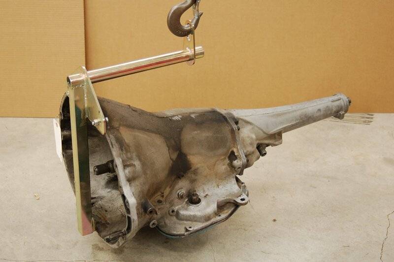

I use a lifting tool to pick up a 727 transmision.

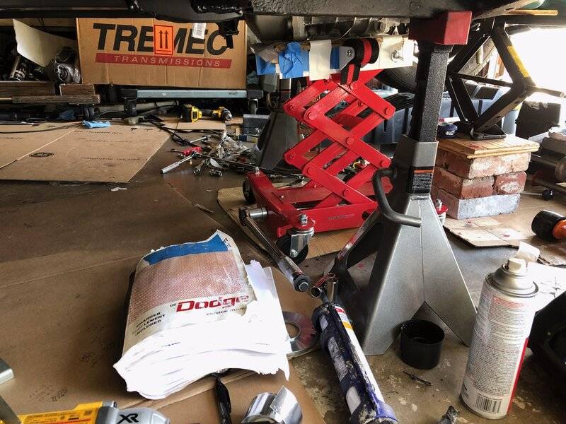

Drilled and taped pad on floor jack in 2 places, 3/8". Cut a 1/2" piece of plywood 3/4" better, trans pan size. Bolted it to jack pad with counter sunk bolts. Added a 5/8" thick 2" wide 12" long on front to tilt trans so of trans was higher.

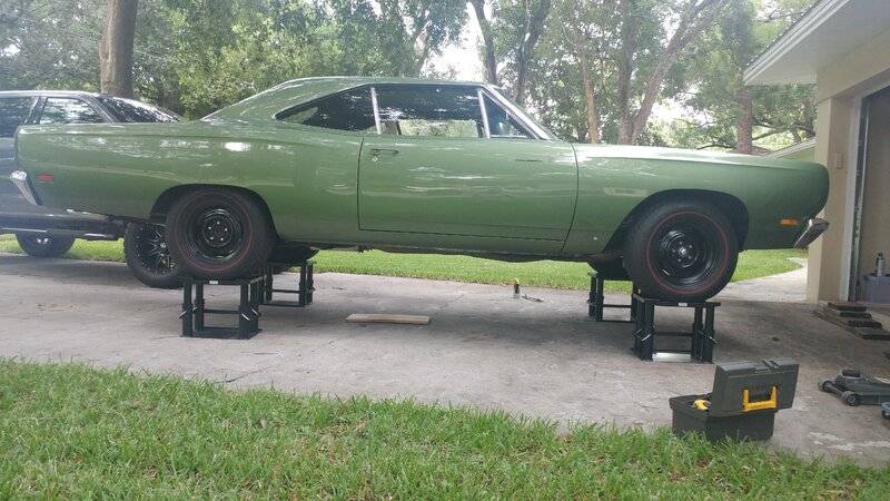

6 ton stand and scissor jack from harbor freight worked for me; at least on my 66 Coronet. no torsion bars in the way. get it up high.
