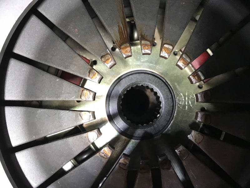

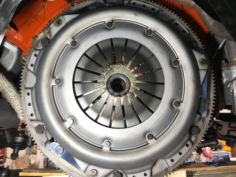

That is my intention as mechanically it’s functioning fine. But I would like to replace the tail housing gasket, fix whatever is going on up front, and install shift fork seals. Right now I’m hoping that doesn’t get into pulling it all apart. I’m hoping I can just unbolt the tail housing and separate it slightly to get the old gasket out and slide a new one in place, probably having to cut it at the top and using RTV to seal the cut. I may not be able to replace the reverse shaft seal if they install from the inside - need to research that. Also want to check out the clutch as I have no idea what’s in it other than it’s a diaphragm type.

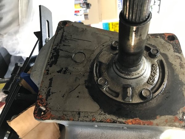

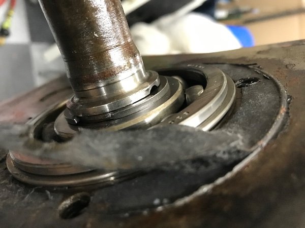

Looks like it’s the input seal. Lots of oil all around the bearing retainer.
The shaft seals actually look pretty dry so I may leave them alone.

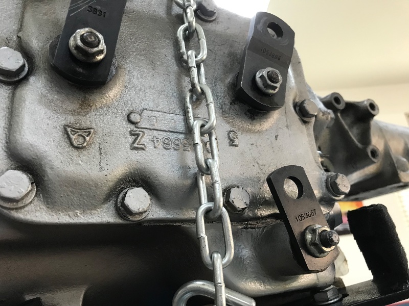

I would like to replace the tail housing gasket if it’s possible without pulling the transmission completely apart.
