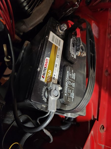

It measures the same as the battery I have in this:
But slightly bigger than what I've had in the red car for a few years.

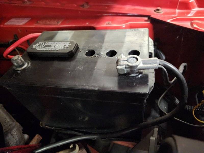

I have been hiding the lightweight racing batteries inside of the repro battery cases when they fail with no issues. Cheaper, they last longer and crank the starter faster.
i also just tried this. The yellow caps battery, I just used one of the cap kits On a generic auto parts store house brand battery. Yes, same battery.
