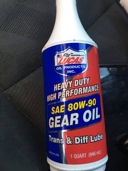

I guess I’m returning the 75w90 I bought and get the 8090
Returned the 75w90 synthetic and got this
