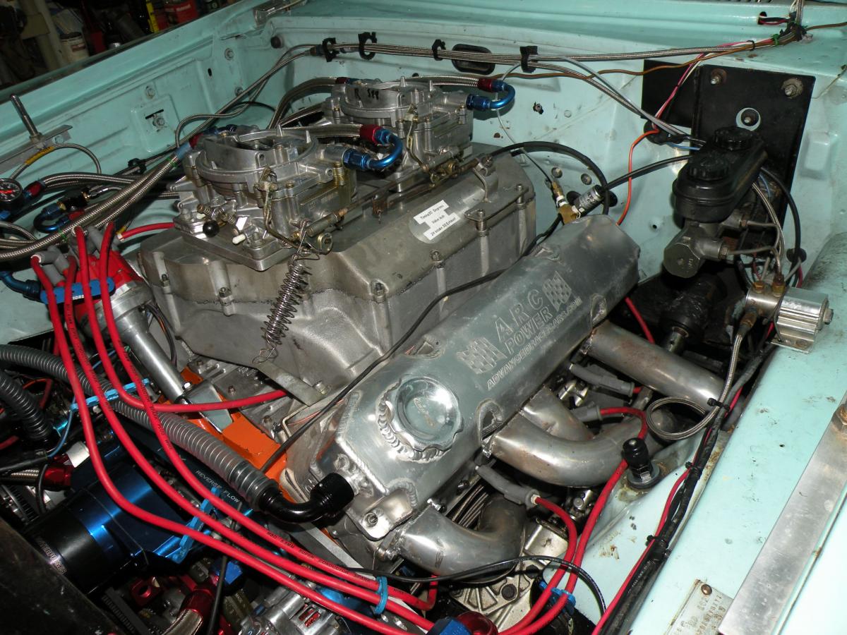

in all my cars, i will only run HURST ROLL CONTROL.
never had one fail on me ever.

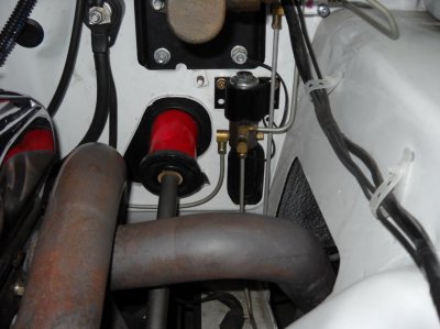

I use the Summit brand Line Lock. Looks very similar to Hurst. About 50 bucks cheaper. No problems "so far". I ditched the horns and wired the line lock to horn relay. People laugh at first but then say that's a good idea. When I get in the water box just stab the brakes, honk the horn, heat up tires, stop honking and roll out.:icon_mrgreen:
