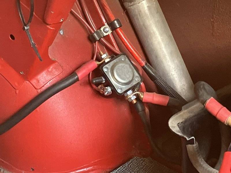

In 2013 I moved the battery to the trunk. The reason? I wanted to move weight from the front and to the rear. This is a classic drag racer trick but it helps for handling too. Our cars are naturally nose heavy so it is beneficial to shift weight to the rear when you can.
I used a steel battery box from an A-100 van. I wired in a FORD solenoid.
This works. I have a 1/0 positive cable going from the solenoid through the interior and through the firewall directly in line with the starter. This 1/0 cable only has power while cranking. I have a trigger wire that sends power to the 1/0 cable to start. The starter has a buss bar on the terminals so once it gets power, it spins. I have a full length ground cable from the battery to the back of the engine and another ground to the rear frame rail. Yeah, it works but lately I’ve thought of the trunk mount setup and what it cost in terms of weight. The battery itself…

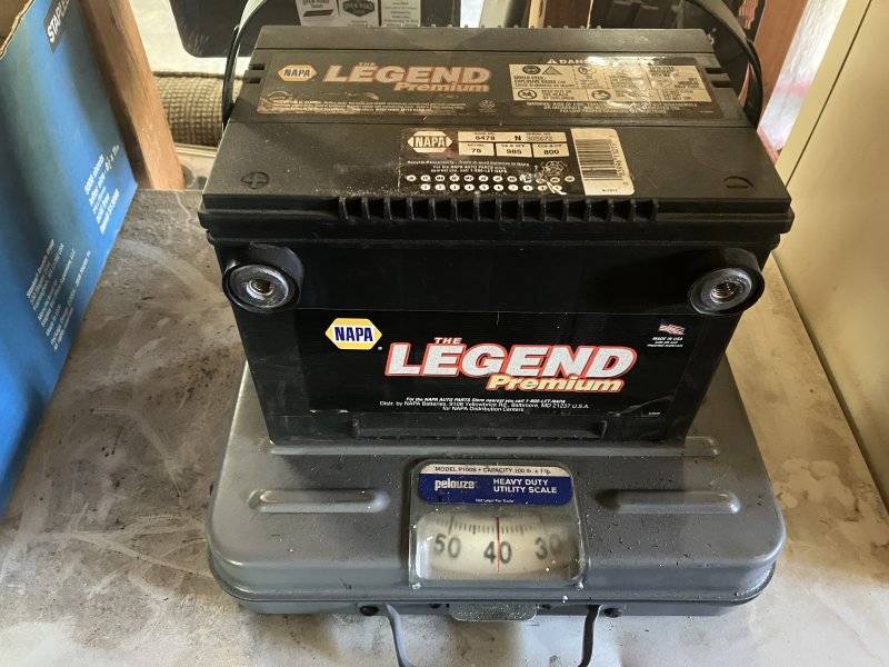

Just a smidge over 40 lbs and it is smaller than a group 24. Add it up… the additional length of the lead cable from front to back, the two grounds and the trigger wire. Moving the battery to the trunk did shift weight but at the cost of maybe another 20+ lbs.
This is why the idea of these lightweight batteries is interesting. If it is possible to have similar or better cranking power with a fraction of the weight, that is tempting. I checked the charge on Dwayne’s battery…
Then I tried it in my car to see how it would start. Wow….the starter spun faster that it ever has. I’ve had my own lead-acid battery to the mid 12s of charge, my charging unit shuts off around 12.7 or so with this NAPA battery. The car starts fine with the NAPA battery but is a lot faster with the higher charge Lithium one.
Why? Is it the extra voltage that makes the difference or the design of the battery?
I really don’t like the extra bulk in the engine bay but if a lithium battery were to exist that was only half to 2/3 the thickness of the lead-acid one, I could live with it. Dwayne’s battery is 7 lbs. Mine is 40 1/2. A front mounted battery could save some serious weight.

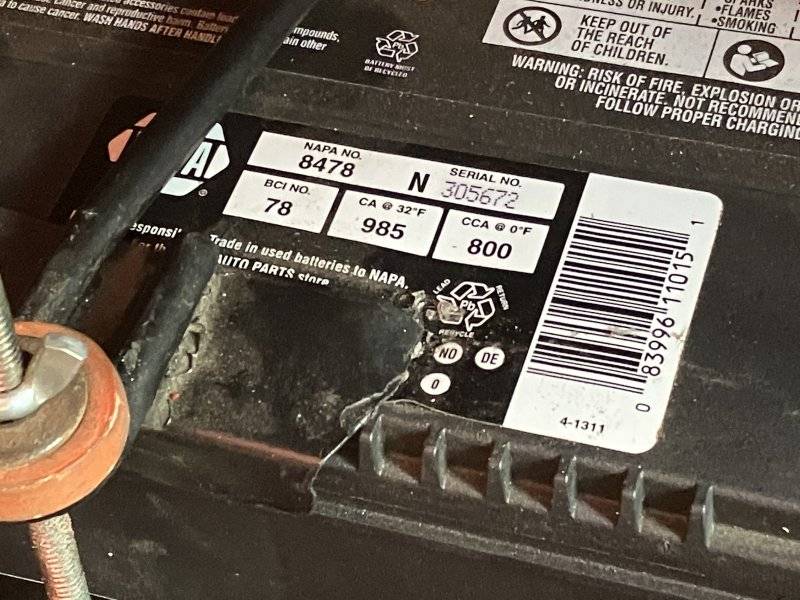

My CCAs are…
I don’t know how relevant that is though. I never am out here trying to start it in 32 degrees of weather. I hate the cold.

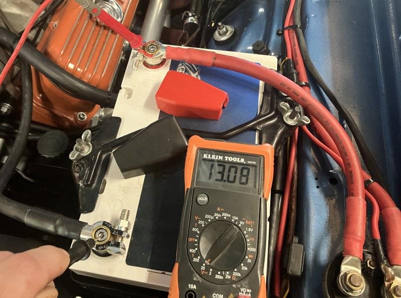

I stupidly left the trunk lid open and the trunk light drained my battery.
I charged it overnight with the trunk open and it didn’t charge all the way. I then did this:
Now it has moved from 11.9 to here in a couple of hours.
My understanding is that I should be between 12.3 to 13.2 to be fully charged, right?
