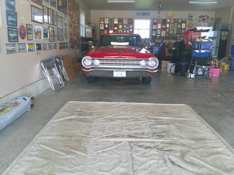

There in a rickety old Garage,
Sits a shiney, new, red Super Stock Dodge.
The little old lady from Copenhagen! (my wife)
Dave you really need to get that garage in order. :p
Hey! It's a working garage. I just finished up a '64 Torqueflite rebuild. I was working on finding a brake noise on the front of the '64 today. I think I found it: when I had my rotors resurfaced, I don't think the guy cleaned them up close enough to the hub. I think the edge of the pad was catching the rough part. I hope I fixed it by grinding a 45 degree relief on the leading edge of the pads.
