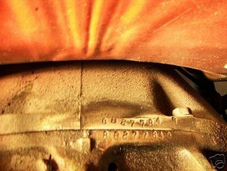

The SON is on the radiator support,fender tag, and drip rail. The VIN is on the Dash, and the engine, located on the rear lip of the block about 11:00, under the kickdown linkage. it should be six digits only.The Vin on the transmission is on the trans side parallel with the engine block. The block should also have the letter D (68)under the distributer for 383, on pad by Power steering pump for the 440.
On our 68 the VIN stamp on block and trans is 8 digits/characters. All reference photos I've seen is Year, plant, last 6 of VIN.
You are correct, I was going by my memory of a 68 Block in the shed with just six. But all the others have eight as stated. I guess it all depended on what mood the guy was in that day. by 69' they got their act together.
My 69' dart actually has all 13 on the block. I noticed The Dodges most likely had 13, and the Plymouths tended to have only eight(69-70)as time went by only eight were stamped, which made it harder to determine exactly what car the engine came from when they did that.
