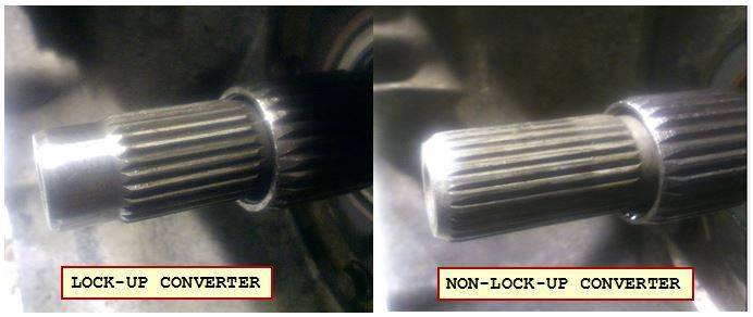

Here's a pic showing the difference of the input shafts
Just to be clear, you can't just "add" a lock-up converter to your 904 unless the transmission was made for it.
