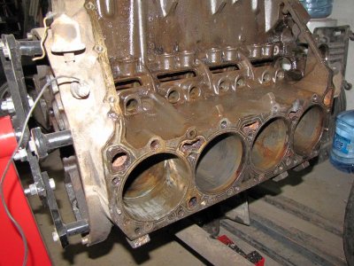

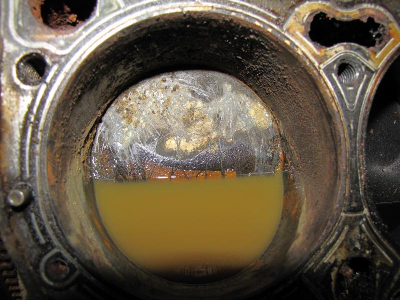

Don't seem to have good luck in acquiring engines that are NOT locked up. Remember that Mustang engine? This 440 came in as a trade for services, the guy told me it was good, no reason to not believe him as he's a friend. It looked like the tarp covering it was under a leaky roof, and water found it's way into 1 cylinder -- which still is locked up. I was able to get the entire thing pulled apart last night (those pics later today) and this was a definite low-mileage motor, cross hair honing marks still visible in the bores!

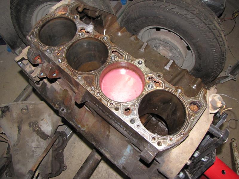

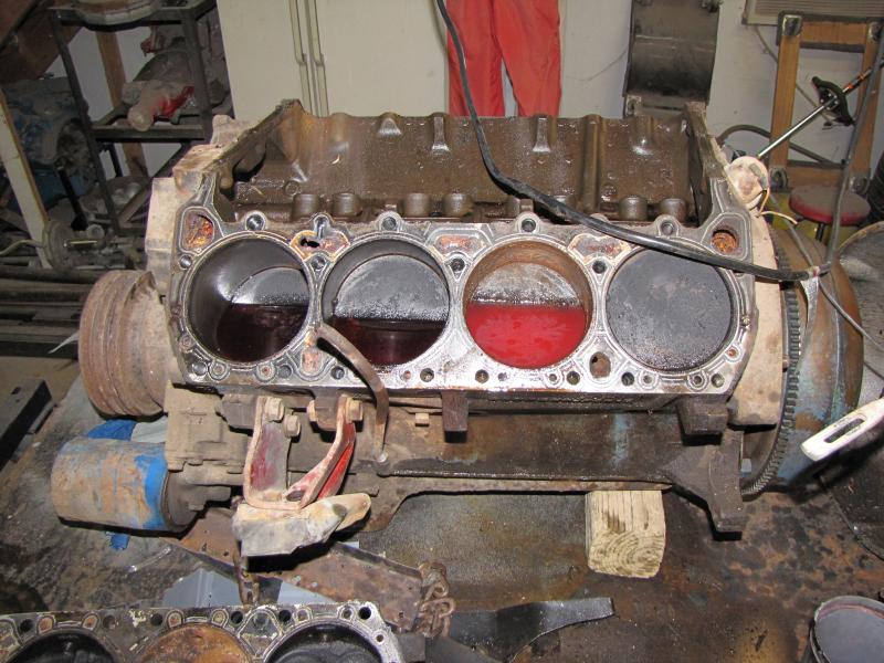

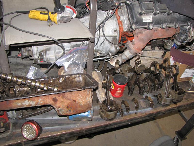

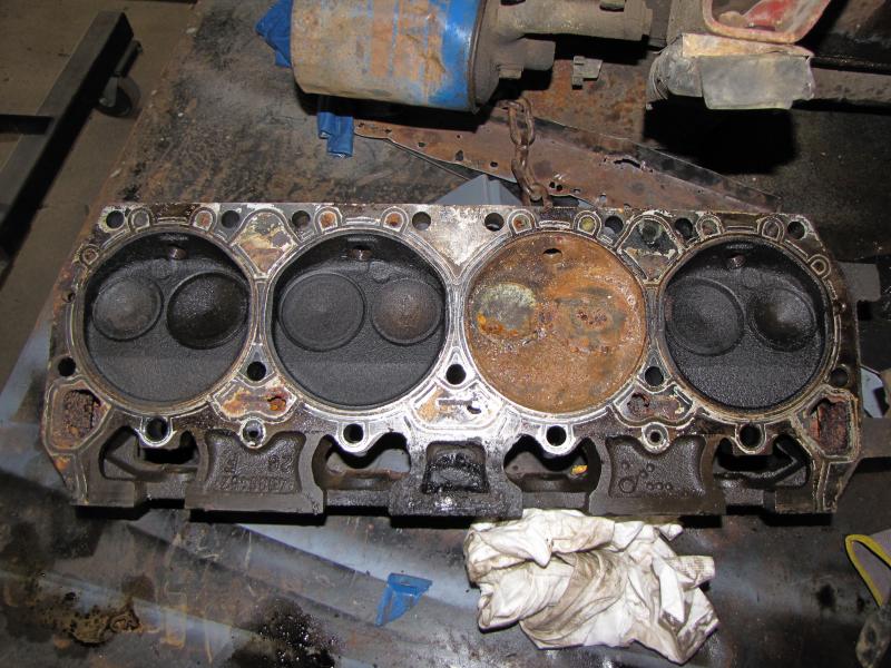

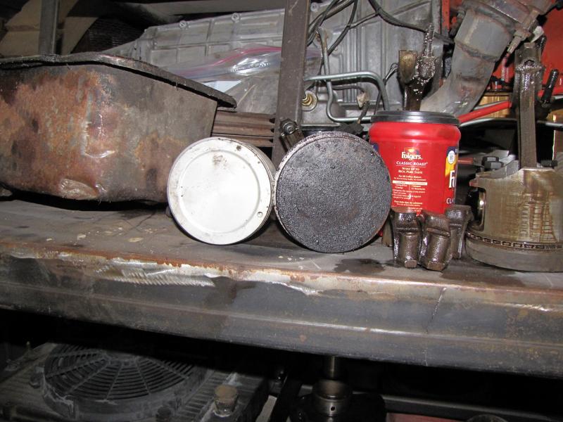

It's a 1976 motor, was told it came out of a New Yorker. Water got into two jugs, but only one piston won't let go. Was able to get the Crank out, not easy, had to move a few tight pistons with a BFH and long brass drift from the bottomside about 1/4 inch to free up Rod bolts. The Rod bolts that I couldn't pop out with a rubber mallet I had to BFH and Brass drift 'em out! Still got one Piston stuck tho. Here's pics. IMG_6960.jpgIMG_6961.jpgIMG_6962.jpg

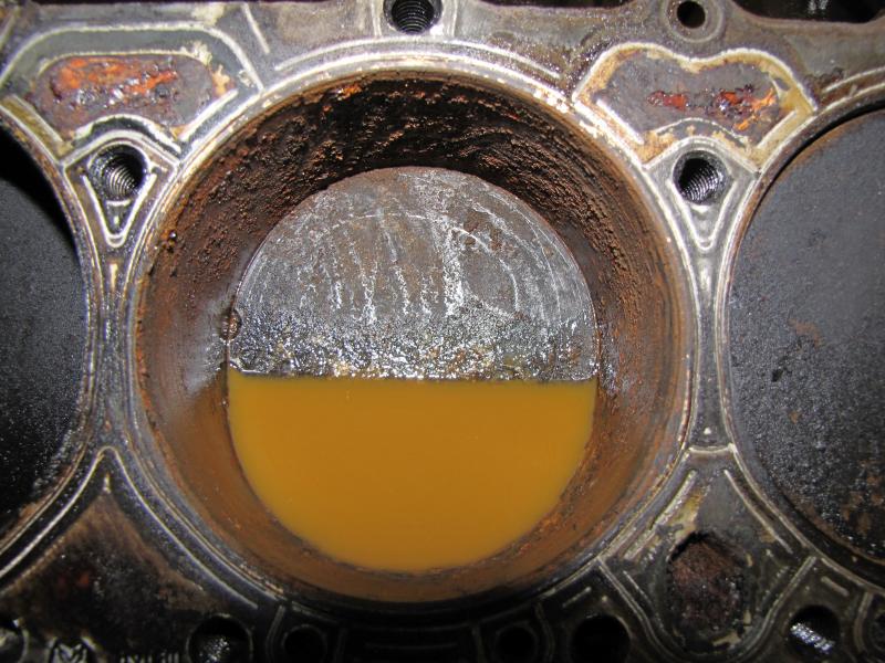

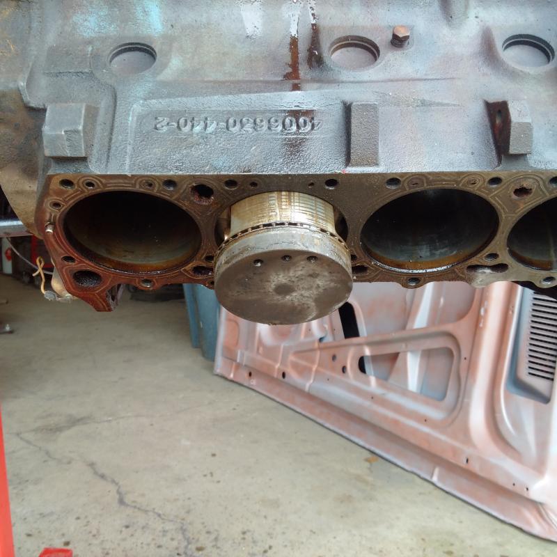

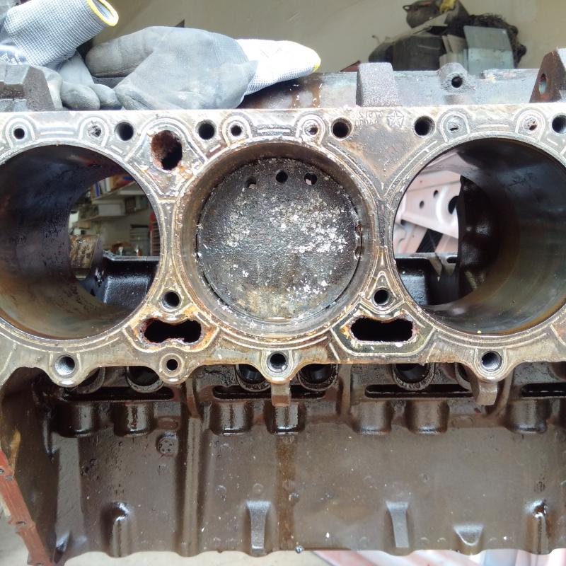

Got the last seized up Piston out. Had to drill three holes in Piston, seemed to have done it! All the rusty scale stuff dissolved in the Acetone/ATF mix.
I have had some pretty stubborn pistons, glad to see you got them out, I just us the bigger hammer method, its where having a really good engine stand pays off, lol...
what are the plans for the engine, obviously clean, mag, and bore, what else? will that clean up at 30?
Build it! Going to put an aggressive Cam in it, all of course assuming the block is good which I think it is, I think 30 will clean it up for sure. This will be the engine that goes in my GTX. It will be the wrong year engine (of course) but, it'll be a 440, built up!
Nice ... :headbang:
Sounds like a good plan,, I am sure the block will mag good, I have done many big chryslers and cracked ones are rare, I have seen some with rear cylinders too far gone (not sure why just the rears on the 4bbl cars are trashed in some motors), but thats why they make sleeves... Good luck with the build, as far as it not being date correct, just put so much paint on it you cant read the numbers, lol...
