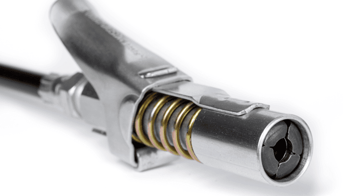

Anyone try these? I use the stink out of my grease gun with boat trailers and outboards. Lot of money for it, but ...

Works wonders, don't think I paid that, but when greasing dirty equipment with lots of zerks it is nice to have, it sucks to look down or up and see a glob of grease oozing out from under the standard tip. Really sucks when laying underneath and the standard tips pop off because you tweaked the hose/tip/zerk and squirts a thread of grease down over your arm.
And I guess it matters just how much grease/pumps of the lever you use for one zerk if it is then worth it. Seems like they (the standard) pop off more or less when you are using the pumping lever more then once per zerk.

And if you had that clip on tip you would not have to hold the hose.
Although with the clip on tip you have to know if there is room to fit a finger and the clip lever at the location.

I got it at my local tractor store & it won't lock onto the zerk fittings on my Deere tractor. Bringing it back today with a zerk fitting that I removed to show them that it doesn't work.
Funny, that exact one is sitting on the counter at my parts store with the display and it seems to work great. I wonder if your grease fittings from JD are a little smaller. Try the ones on one of your old cars?
I brought a fitting with me to the tractor store where I bought it Nd their display model would lock on my JD zerk, so he pulled another one out of the package & it didn't work either, but they both would lock on their display zerk, so I just returned it and got my money back.
I did order one that the OP showed and it just came in today and sure enough, it does work on my JD zerk.
