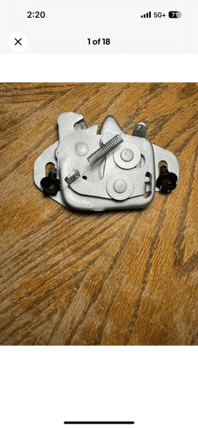

Hood latch was labeled as:
72 Dart 72-73 Fury Polara Monaco Newport New Yorker Hood Latch.

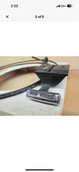

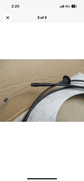

Hood release was:
Mopar 1972-74 A-Body Plymouth Valiant Dodge Dart Hood Release Cable 3695563

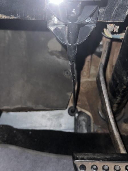

Just installed the pull handle straight from hole in firewall, doesn’t seem to get in the way of anything, easily accessible and visible.
Latch footprint is exact to the old one, so just two bolts come off, and the new one goes in.
Made holes in radiator support for the cable. There needs to be a clamp right next to the latch as seen here to avoid slop and loose pull feel. Also needed a stack of washers to clear the latch. Will replace with a spacer later.
