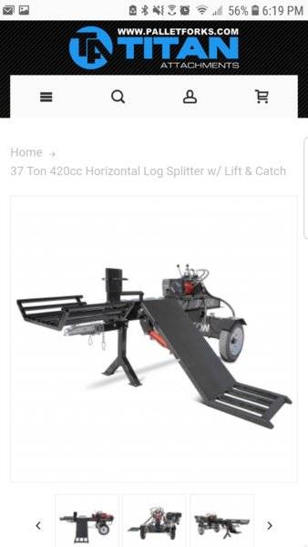

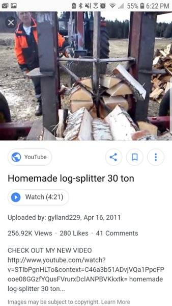

Yes but it's electric and spoken for, I'm more focused on the splitter side of it right now. The pics above show what I'm thinking, combine the horizontal self loading splitter with the multi cut thingamajiger and you'll get where I'm going. Being elevated will give me the option of putting a conveyor under it so it's loading the truck too:thumbsup:.

I saw that and really liked it but I'm thinking it would require a massive frame and plenty of oomph to do that to a log.
But I thought that's what your lookin for, and that big *** pile in the background waitin to be cut & split.

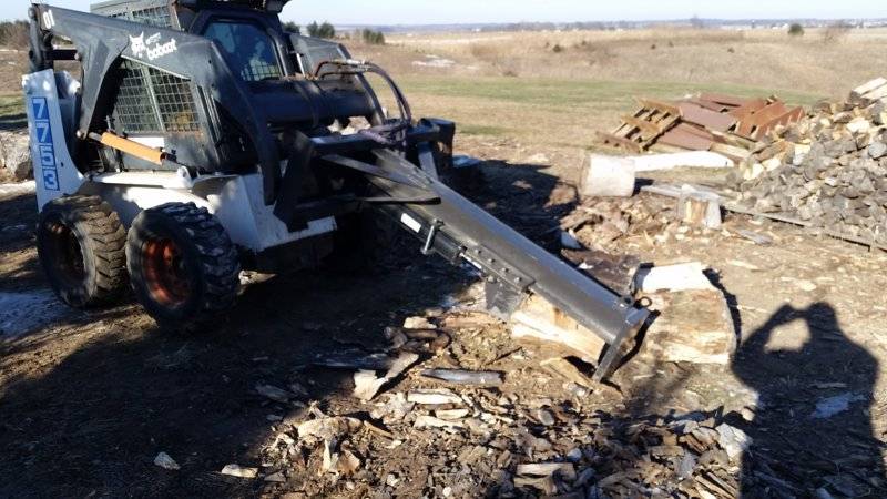

There's always this?
Or this for da big jobs!
