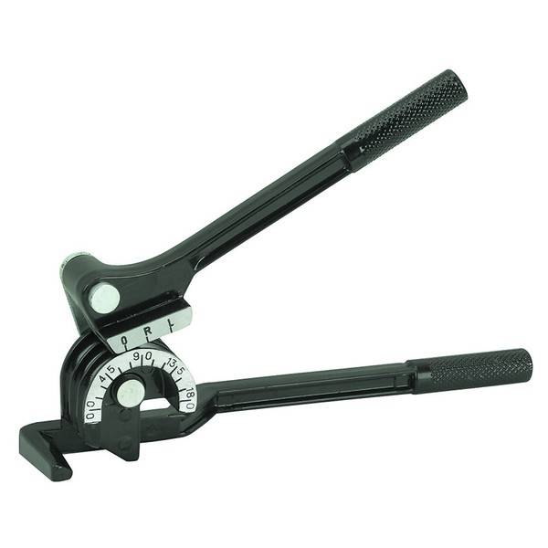

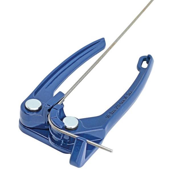

I looked up some tube benders and they cost more than the tube/dipstick sets. Maybe Horror Freight has a bender that would be capable of making some mild bends on the tube I bought from Classic Industries without breaking the bender or my tube in the process.. I suppose I could also use a bender in the future to make new fuel line running to my dual feed carb.
"Men's Mall" = bone yard.
Harbor Freight
$8.00
$10.00
