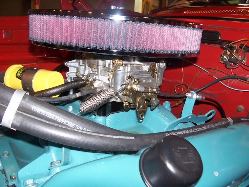

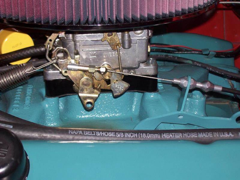

this is what the throttle cable without mechanical kickdown lever looks like on RB block
......the cable is great! need to fabricate hardware to work.

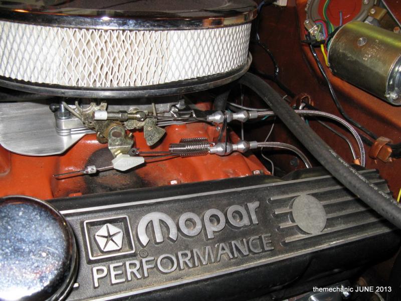

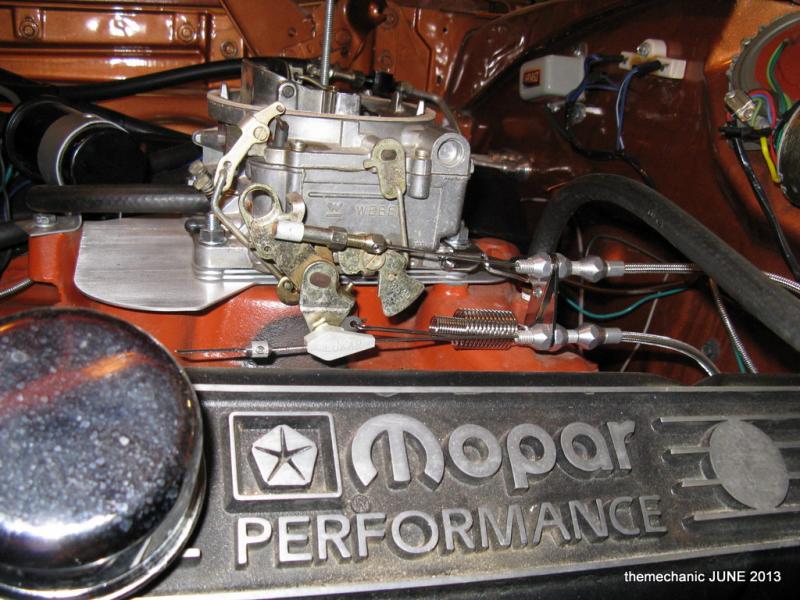

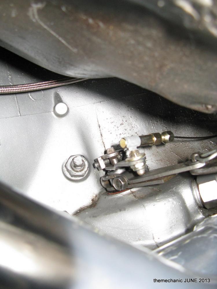

I installed both Lokar cables on my 1969 Coronet R/T with Edelbrock 1407/750. I'll send you some photos later this afternoon.
Here you go.
